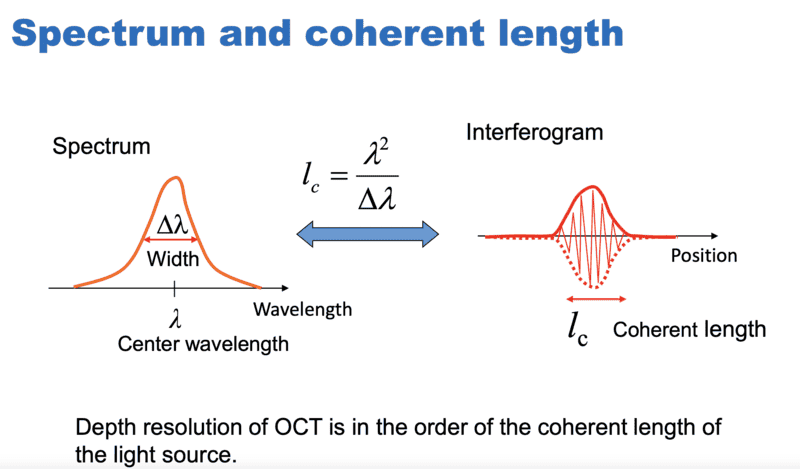

I got the reference from my class material like this pic

nao113 said:
so the answer will be 14726.7 nm?
That would still lose a mark (even if correct) due to excess significant figures!
However, from your attachment it appears that in your course, you are:
- using Δλ to mean the FWHM;
- using C=1 in the equation ##L = C \frac {λ^2}{Δλ }## (technically not correct, but never mind).
So, based on your course material, your original answer (in Post #1) would be correct if you rounded it properly.

Thank you very much for your answer. Can you please tell me what the correct one is? Actually, I also tried this calculator https://www.calculatoratoz.com/en/coherence-length-of-wave-calculator/Calc-31767 and just like what you said it uses C = 1/2

Can you tell me what your Post #1 and Post #3 answers are when correctly rounded to the appropriate number of significant figures? If you are not sure how to do that, at least try! If wrong, I will help.
There is no single correct answer - it depends which formula you choose to use. If this is work to hand in, and I was the student, I would answer something like this:
Using the formula from the course (##L = \frac {λ^2}{Δλ }##) gives:​
<Give working and correctly rounded answer>​
However, it should be noted that coherence length is sometimes defined with an additional factor (typically ½), e.g. see (reference of Wiki article) giving ##L = \frac {λ^2}{2Δλ }##. This gives:​
