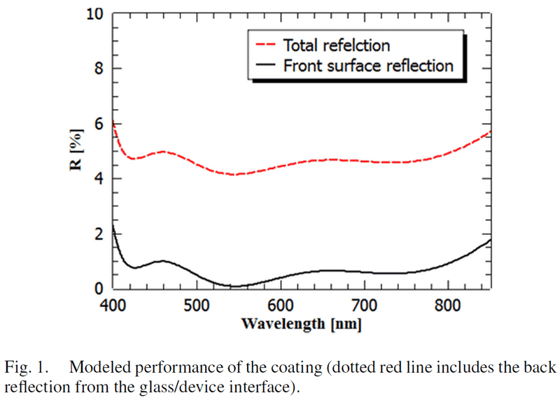

I have an optical interference filter that is used to block (reflect) solar light heat between 800nm and 1100nm. That filter is made by using 200 layers of quarter wave high and low index coatings on plastic film. The total thickness of the coating is 25 micrometers or even 50 micrometers.
I was told that interference effect can only happen when the thickness of coating is less than coherence length of light. How can my filter work when the total thickness of interference coating is much larger than the coherence length of solar light that is only about one micrometer?
I can understand locally the adjacent coating layers can still have interference effect but how can the light beam reflected by the top coating layer interfere with light beam reflected by bottom coating layer since the optical path difference between these two beams is far larger than coherence length of solar light?

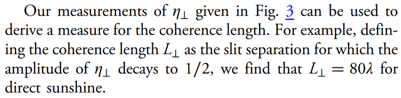

From this reference: Spatial coherence of sunlight... I quote an excerpt (from pg. 98):
So for a solar wavelength of ##0.5 \mu\text{m}## the coherence length ##L_\bot## amounts to ##40 \mu\text{m}##.

renormalize said:
The coherence length of sunlight is significantly larger than ##1 \mu\text{m}##.

That is spatial coherence or the transverse coherence length. It tells you how point-like the light source is or what the maximal separation of slits may be to observe interference in a double slit experiment.
For interference filters, the longitudinal coherence length (coherence time times the speed of light) is the relevant quantity. The coherence time is essentially given by the Fourier transform of the power spectral density of your light field. Simply speaking: a broad spectrum results in a short coherence time. Therefore, one may improve coherence time by spectral filtering. Depending on what is going on in the atmosphere, sunlight filtered by the atmosphere is usually considered to have a coherence time on the order of one to few femtoseconds:

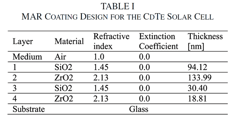

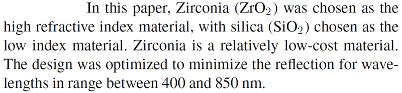

This is the key! In my previous post above I incorrectly cited the spatial/transverse coherence length of sunlight, but the crucial parameter for multilayer interference-filters is the temporal/longitudinal coherence length, which is indeed ##\sim 1\mu m## as stated by the OP. As long as each individual layer thickness is less than this value, a multilayer filter will work for any overall stack height. Here's a reference that discusses designing filters by this criterion: Optical model for multilayer structures....
From the introduction:
"Optical models for thin-film multilayer structures are used in several important applications such as design and analysis of optical coatings and thin-film solar cells. The objective of these optical models is to predict reflectance, transmittance or absorption depth profile as a function of wavelength. For accurate calculation of these parameters it is crucial that the interference between multiple internal reflections is taken into account correctly. Thus far this has been especially challenging for thin-film solar cells which typically have an absorber layer thickness on the order of the coherence length of the incident sunlight. Layers with an optical thickness less than the coherence length of the incident light cause observable interference fringes and are commonly referred to as coherent layers. Much thicker layers, that do not give rise to observable fringes, are referred to as incoherent layers. Partly coherent layers represent the intermediate case."

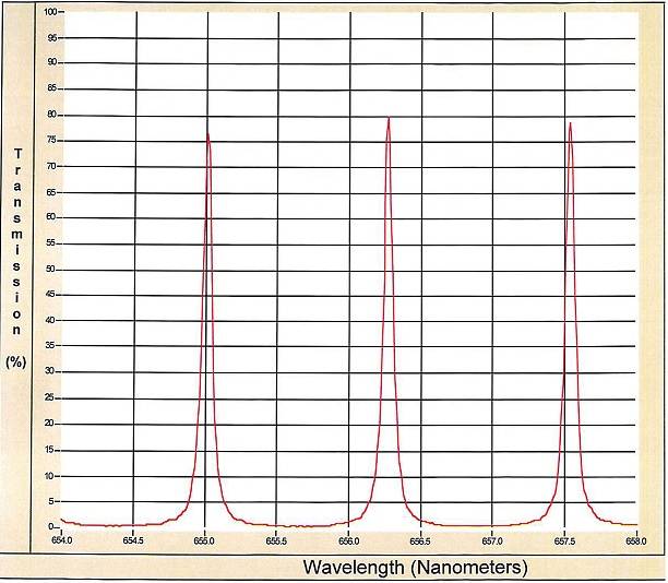

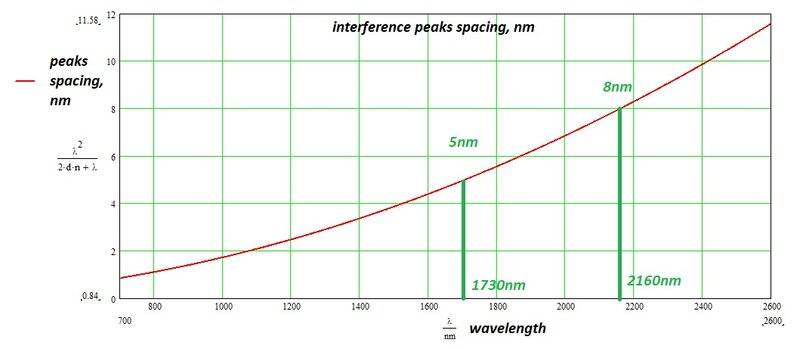

Another example I can take is the Lunt Fabry–Pérot interferometer used for the observation of the Sun in H-alfa.
From the picture above it is easy to calculate that the path length between two parallel mirrors is 525 waves or 344µm. The width of the narrow peaks suggest that reflective coefficient is about 0.9 or so. Taking into account that the light is traveling the gap multiple times, > 20..30 times to decay, that gives the coherence length well above 2..3 cm to make it works.

The calculation for the distance between mirrors in a Fabry-Perot cavity is ## d=\frac{\lambda^2}{2 \, \Delta \lambda} ## (where ## \Delta \lambda ## is the spacing between peaks in the spectral transmission curve) which is one half of what you computed. (Comes from ## m \lambda_1=2nd ##, and ## (m-1)\lambda_2=2nd ##).
Meanwhile a google seems to suggest that the coherence length of the H alpha line is a few millimeters, and I think it is likely that it has a longer coherence length than the blackbody type portion of the solar spectrum.

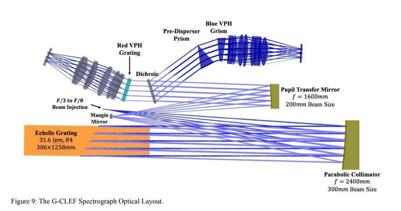

May I refer to the echelle spectrometers used for star and Sun observation?
In multilayer coating interference is occurred between reflections from multiple layers, in diffraction gratings interference is occurred between light diffracted from different grooves across grating aperture. Echelle gratings are used with large angle of incidence that makes quite large path difference across the aperture.
How large the size of echelle gratings that used for stars/sun?
There are plenty references about 300..400 mm size.
The echelle spectrometer for Giant Magellan Telescope (GMT) is planning to us echelle with 0.3 x1.25 m size (here is the link The optical design of the G-CLEF Spectrograph ),:
That would be above 1m of the optical path different across the aperture. I understand that they assume that the light from stars would be coherent otherwise it would be not possible to realize the planned spectral resolution of the spectrometer.
