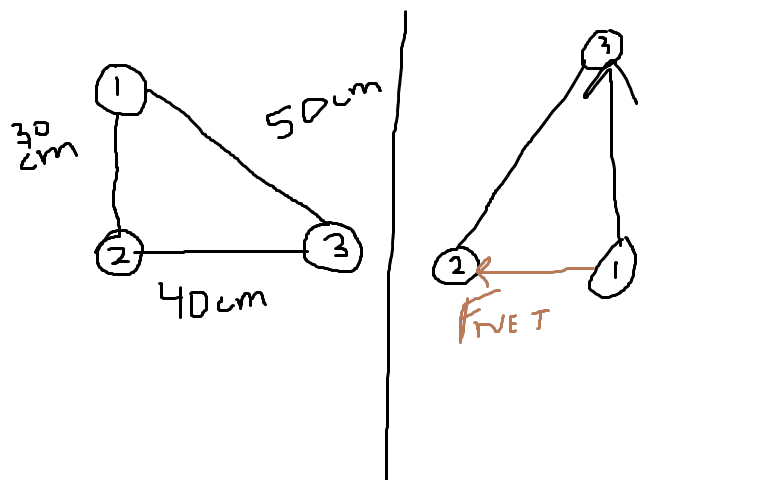

3 charges are arranged in the diagram below. their magnitudes are:
q1=2.5*10^-17C
q2=3.0*10^-17C
q3= 3.5*10^-17
calculate the direction and magnitude of q1
F=kq^2/r^2
well, i used f=kq^2/r^2, the charge of q3= (9*10^9)(3.5*10^-17)^2/(0.5)^2= 1.2*10^-17
q2=(9*10^9)(3*10^-17)^2/(0.50)^2= 3.24*10^-17N
im unable to find the angle of q1, how would i solve it really confused, i know you can use cos law but angle unknown, thank you
I'll assume you mean the direction and magnitude of the force on q1 :smile:

sorry, i just minimized the formula since it was late, i know I am suppose to use
F=q1q2/r^2 ( but how do i do this, I am really confused) this question , could it be resolved in components ?
After you calculate F=kq1q2/r^2, and think about what direction that force is acting, then yes you resolve it into components.
so do i calculate the charge from q1-q3, and q1-q2 :S, sorry the question is really bothering me
You calculate the force from q3 on q1, and the force from q2 on q1.
You don't have to calculate any charge, the charge values are provided in the problem statement. The problem is to calculate force, not charge. They are two different things. Force is not charge. Force is not charge. Force is not charge. Force is not charge.
ok i think i got it, but how would you draw a diagram if the one charge was attractive, in this case all the charges are repulsive
You're calculating the force not the charge. The force q1-q3 is:
[tex]F = k_e \frac{q_1 q_3}{r^2}[/tex]
The force q1-q2 similarly.
[tex]F = k_e \frac{q_1 q_2}{r^2}[/tex]
You can find the angle in q1 corner using the tangent function. Now sum them like vectors and you're done.
okay , so using the pythagorean theorem, since hypotenuse is known it would be
b^2=a^2-c^2 ( then I am done) :) , if that's all i thank you all for the help
okay, the charge of 1 to charge 3 is (9*10^9)(3.5*10^-17)(2.5*10^-17)/(0.3)^2
= 8.75*10^-23N
then, charge 1 to 2 is (9*10^9)(3*10^-17)(2.5*10^-17)/(0.5)^2 = 2.7*10^-23
after i have these 2 charges i have to do pythogorean theroem but for the unknown side I am getting a negative root ans
Okay, we are starting to get somewhere now. But something is rather confusing. In the drawings you show in Post #1, the distance between charges 1 and 3 is not 0.3m. The distance between charges 1 and 2 is not 0.5m. But these are the distances you used in the calculations of the forces.
Question: which of the two figures you showed earlier is the correct configuration of the charges?
Finally, if I may politely ask you ... please stop using the word "charge" when you really mean (or should mean) "force". It indicates that you are not really paying attention to what you are doing or what we are saying.
ok , sorry about that, but I am getting it a little more the correct configuration is the one to the left. the reason i drew the one to the right is to show the repulsive forces that q1 experiences.
Okay, thanks for clearing that up. You'll need to recalculate the forces using the correct distances between the charges.
no problem, i thought i already calculated the force b/w q1 and q2, likewise i calculated the force between q1 & q3 ,would'nt i need to draw a diagram showing the repulsive forces on q1( the picture to the right) ?
Cudi1 said:
no problem, i thought i already calculated the force b/w q1 and q2, likewise i calculated the force between q1 & q3 ,...
Reread my post #14, especially the part about the distances between the charges.
I thought the picture to the right was incorrect? The pictures can't both be correct, since they show the charges in different arrangements.
I have to say, you do need to be careful and pay more attention, otherwise there is no way I can help you out.
