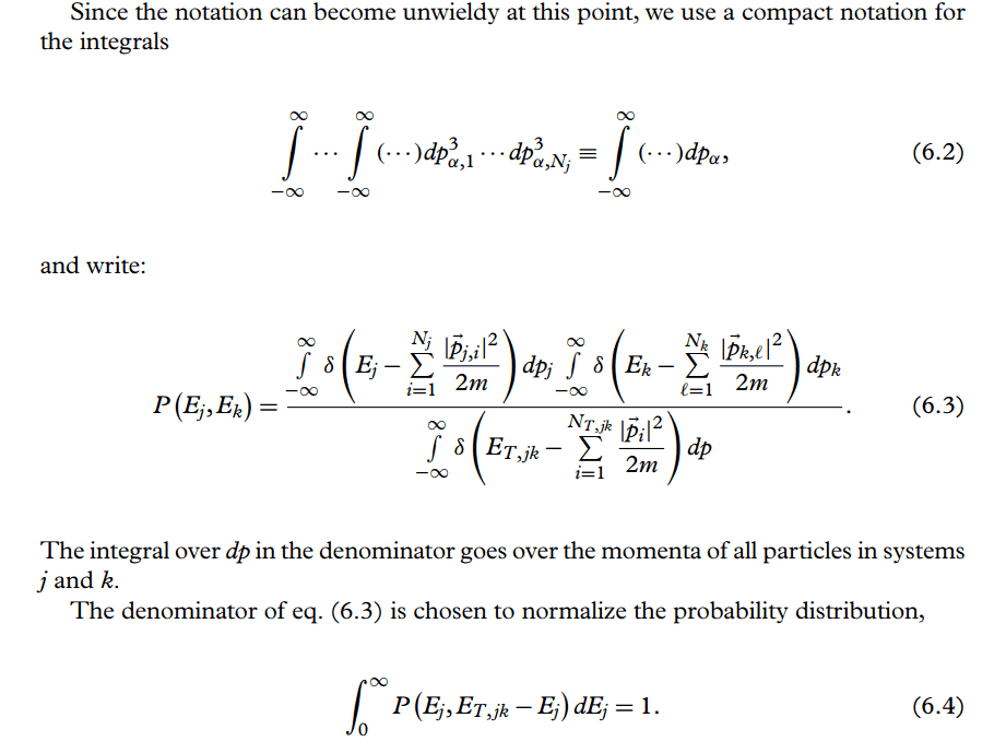

Suppose we have two systems ##j## and ##k## of volumes ##V_j## and ##V_k## and particle numbers ##N_j## and ##N_k##. The particles do not interact. The systems are isolated from each other. Suppose we are given the total energy ##E## and we are interested in the probability distribution ##P(E_j, E_k)## where ##E_j + E_k = E = const##. We make the assumption that all particle momenta are equally likely, but they satisfy the constraint ## E=\sum_i^N \frac{p_i^2}{2m} ##, where ##p_i## is the momentum of the ##i-th## particle, ##m## the particle mass, and ##N=N_j + N_k##. The same energy-momentum relation holds in each subsystem.
Now consider this section that the author allegedly makes use of:
I already found a heuristic proof for this, so let's accept this as a given fact.

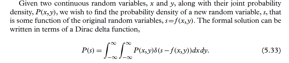

Now he wants to derive the distribution of the two energies from the momenta making use of (5.33). He writes:
I don't understand how he actually ended up at (6.3). Given (5.33), what we can write is
$$\begin{align}
p_{E_j}(E_j) & = \int_{-\infty}^{\infty} p_{p_j}(p_{j,1},p_{j,2},...) \delta \left( E_j - \sum_{i}^{N_j} \frac{p_{j,i}^2}{2m} \right) \, dp_j , \\
p_{E_k}(E_k) &= \int_{-\infty}^{\infty} p_{p_k}(p_{k,1},p_{k,2},...) \delta \left( E_k - \sum_{i}^{N_k} \frac{p_{k,i}^2}{2m} \right) \, dp_k,
\end{align}$$
where ##p_{p_x}## and ##p_{E_x}## are the distributions of momenta and energies in system ##x##.
The joint distribution of all momenta should be writable as
p(p_{1}, p_{2},...) = \frac{ \delta \left( E- \sum_i^N \frac{p_i^2}{2m}\right) } {\int_{-\infty}^{\infty} \delta \left( E- \sum_i^N \frac{p_i^2}{2m}\right) \, dp}.
Now, all the delta functions are there, one just has to combine them properly...
It is clear that ##P(E_j, E_k) \neq p_{E_j}(E_j) p_{E_k}(E_k)## (since the energies in the subsystems are linearly dependent, i.e. fully correlated). In the same way, the joint momentum distribution cannot be written as a product of the joint distributions in the subsystems...
It is also clear that ##p_{E_k}(E_k) = p_{E_j}(E-E_k) ##.
If one interprets the delta-"functions" as living under energy integrals, one can also write
\delta \left( E- \sum_i^N \frac{p_i^2}{2m}\right) = \delta \left( E_j - \sum_{i}^{N_j} \frac{p_{j,i}^2}{2m} \right)\delta \left( E_k - \sum_{i}^{N_k} \frac{p_{k,i}^2}{2m} \right). $$
Any idea from here?

As for (6.3)
Numerator : (volume of spherical shell in ##3N_i## dimension p-space for radius^2##=E_i## )*(volume of spherical shell in ##3N_j## dimension p-space for radius^2=##E_j##)
Denominator: volume of spherical shell in ##3N=3(N_i+N_j)## dimension p-space for radius^2##=E##
Numerator consists of cut two parts of Denominator by plane ##E_j=E-E_i## for specific ##E_i## and ##E_j##. So by integrating cut parts
\frac{\int \int \delta(E-E_i-E_j) Numerator \ dE_idE_j}{Denominator}=1
It means
\frac{Numerator}{Denominator}=p(E_i,E_j)

Thanks for the examples, @anuttarasammyak , I am beginning to understand this geometric approach.
But shouldn't the density then be given by
p(E_j, E_k) = \frac{\delta\left(E-E_j - E_k\right) numerator }{denominator}?
Since integrating this over ##E_j## and ##E_k## gives 1. And integrating this numerator over small energy intervals would give fractions of the area of the 3N-sphere. Dividing this fraction by the total area given in the denominator gives the probability to find the energies in the intervals.
That would imply that (6.3) is incomplete.
By author's definition
\int \int p(E_j,E_k)\delta(E-E_j-E_k)dE_jdE_k = \int p(E_j,E-E_j)dE_j=1
By your defnition
\int \int p(E_j,E_k)dE_jdE_k = \int \frac{Numerator(E_j,E-E_j)}{Denominator}dE_j=1
So it depends on how the normalization is defined.
