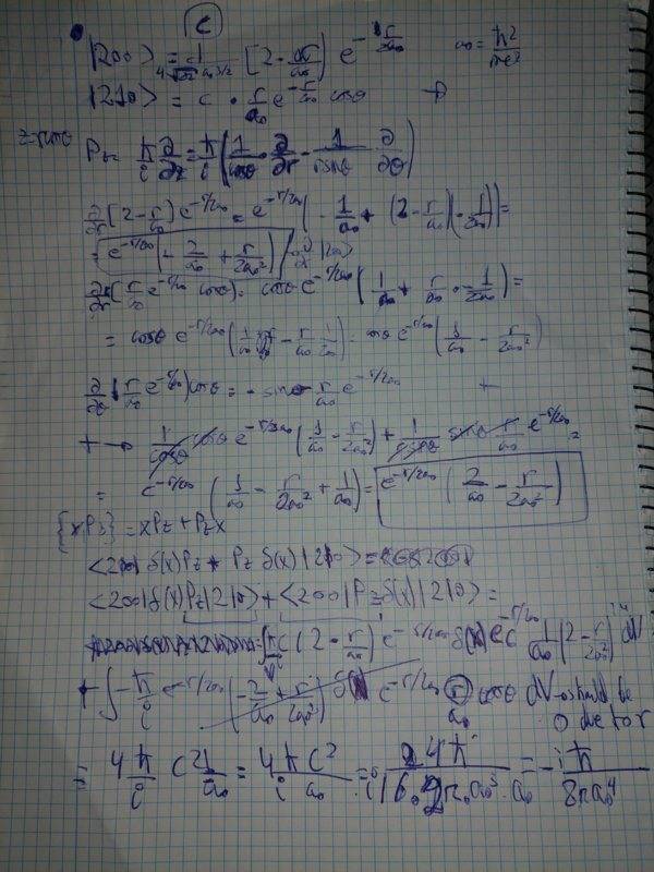

Calculate. <2,0,0|&(x)P_z+P_z&(x)|2,1,0>
Where |n,l,m> are the hydrogen atom eigenstates, &(x) is dirac delta and x is the position operator . It should be -iħ/(16pia_0^4) a_0=ħ^2/me^2 .
Not many
My solution is not the same, it has an additional *2 factor and i can't see any mistakes.
You may be lucky and find someone who can spot the mistake in that lot. It's practically illegible to me, I'm sorry to say.
At the very least, you could write out legibly what you've got - or, ideally, learn Latex:

I will chime into say yes, please use the LaTeX guide to format your question in readable format. That doesn't describe every LaTeX feature, but most of what you need to ask your question. But also to give some examples. It's not that hard to learn.
Here is your question with the LaTeX.
Is that all meant to be one equation? Perhaps this one?
##\left [ -i \hbar / (16 \pi a_0^4) \right ] a_0 = \hbar^2 / me^2##
