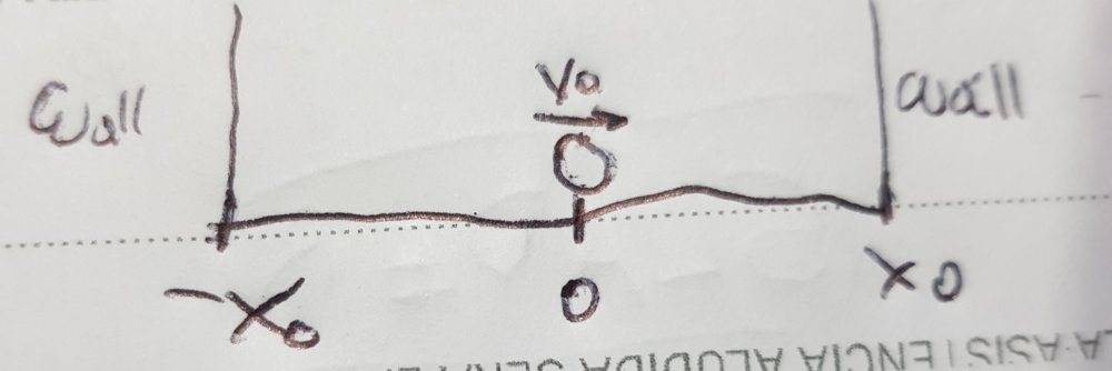

A particle of mass ##m## moves with velocity ##v_0## and collides with the wall. Determine the period of oscillation if:
A) The collisions are perfectly elastic
B) The kinetic energy of the ball decreases 2 % with every collision. The period will be a function of the number of collisions.
##d=tv##
For A) I just have to calculate the time taken to travel from the middle to the wall and multiply that number by 4, since it travels the same distance 4 times.
##t=\frac{x_0}{v_0}##
B)The energy is an exponential function
##T(n)=T_0.(1-\frac{2}{100})^n##
So
##v^2={v_0}^2.(1-\frac{2}{100})^n##
Then I just have to replace that value in the formula from the previous exercise (taking into account that the latest expression is squared)
Is this right?

Yes, that's a good approximation, but strictly speaking one oscillation will involve (if it starts in the middle) three different speeds.
