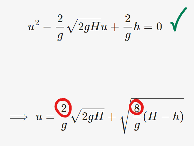

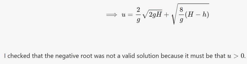

Hi @erobz, can you check your working that I put below which you did in post #18 above? I think you are off by a factor of 2. I put your workings on the right, with the mistakes in red ink.
Let me copy and paste what I am getting. I mark the final expression for ##u## in orange.

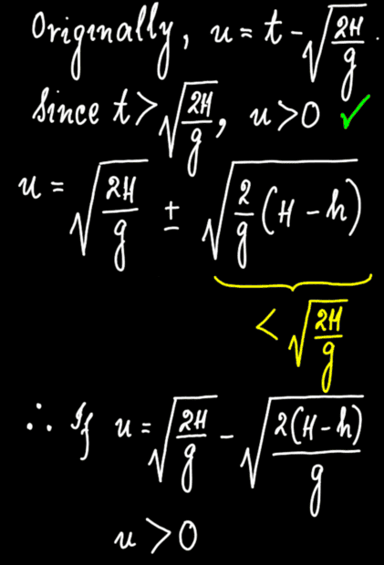

View attachment 339078What's more, I did not understand your reason for keeping the positive (##+##) sign for ##u##. I copy and paste your reason to the right.
Indeed, ##u = t-\sqrt{\frac{2H}{g}}## and since ##t>\sqrt{\frac{2H}{g}}\Rightarrow u>0##. But is that the reason to keep the ##+## sign?
See my reasoning below to the right on dark page.
What I am saying basically is that the second term is less than the first in the expression for ##u##. So keeping the ##-## sign continues to keep ##u>0##.
Many thanks.
Yes, you are correct on both accounts. I goofed on the algebra, and one of the solutions cannot be ruled out by negative time.
So if both solutions are positive for ##u##, must we then take the smallest of the two as the desired solution? ( i.e. ## u = \frac{1}{g}\sqrt{2gH} - \sqrt{\frac{2(H-h)}{g}} ## ) or do we just work with both solutions ##\pm## ( I'm leaning towards the former)?

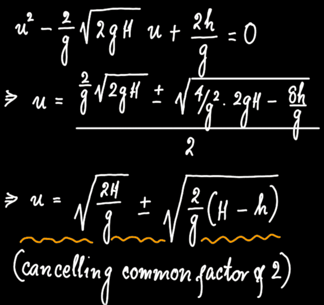

@erobz, you were right. I think I have solved it, though a question lingers. Since it has been sometime that I have posed the problem, let me state things from the beginning to refresh.
Attempt :
Taking ##g = 9.8\:\text{m/s}^2##, we have the equation of motion of the first ball as (see my post #1) shown on the right. Here ##h## is the height where the balls meet, ##t## is the time when they meet (from the start, when the first ball was dropped). The equation of motion of the second ball (see my post #1) is also shown on the right. The question is now to find the height of the cliff H (=?).
In ##(1)##, let us put ##\color{blue}{u = t-\sqrt{\frac{2H}{g}}}\qquad \color{brown}{(3)}##
This, after some algebra, we obtain ##\small{u^2-\sqrt{\frac{8H}{g}}u+\frac{2h}{g}=0\Rightarrow u = \sqrt{\frac{2H}{g}}\pm\sqrt{\frac{2(H-h)}{g}}=\sqrt{\frac{2}{g}}(\sqrt H\pm \sqrt{H-h})}##
Substituting from ##(3)## for ##u=t-\sqrt{\frac{2H}{g}}=\sqrt{\frac{2}{g}}(\sqrt H\pm \sqrt{H-h})\Rightarrow t = \sqrt{\frac{8H}{g}}\pm \sqrt{\frac{2(H-h)}{g}}##.

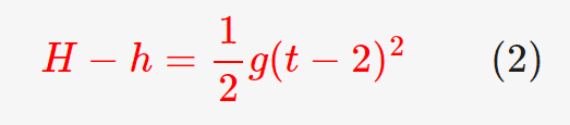

From equation ##(2)##, we have ##\sqrt{\frac{2(H-h)}{g}}=t-2\Rightarrow \color{blue}{t = \sqrt{\frac{8H}{g}}\pm (t-2)}\qquad \color{brown}{(4)}##
There are two possibilities to ##(4)## as evidenced by the ##\pm## sign.
##1. \;\mathbf{(-)\,\text{sign}}## :
This yields from ##(4)##, ##2t-2 = \sqrt{\frac{8H}{g}}\Rightarrow t= \sqrt{\frac{2H}{g}}+1\Rightarrow t-\sqrt{\frac{2H}{g}}=1\quad(=u)##. Putting this value of ##t## in ##(1)##, we have,
##\small{h = \sqrt{2gH}-\frac{1}{2}g\Rightarrow h+\frac{1}{2}g = \sqrt{2gH}\Rightarrow 55+5=\sqrt{20H}\quad\text{(putting values here)}\Rightarrow 60^2=20H\Rightarrow} \boxed{H = 180\,\text{m}}\quad\large{\color{green}{\checkmark}}##
This agrees with the answer.
##2. \;\mathbf{(+)\,\text{sign}}## :
This yields from ##(4)##, ##t=\sqrt{\frac{8H}{g}}+t-2\Rightarrow \sqrt{\frac{8H}{g}} = 2\Rightarrow H = \frac{4g}{8}= 5\,\text{m}\quad\huge{\color{red}{\times}}##.
Of course this answer is incorrect, as the problem states that the ball collide at ##h = 55\,\text{m}##. But it should mean something that I am not able to figure out.
