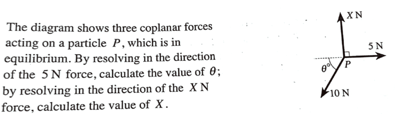

See attached- i am doing self learning in this area...insight is welcome
Mechanics
My take,
##5 \cos 0 = 10 \cos θ##
##\cos θ = 0.5##
##⇒θ = 60^0##
and
##X= 10 \cos (90^0-θ)=\cos 30^0= 8.66## (to two decimal places).
...insight welcome
Not sure anyone works with degrees outside a classroom anymore. From a Mathematical perspective, it may be a good idea to bring up the periodicity of the (arc)sine.
Looks good. Just one small inconsistency in your equations:
but
##X= 10 \cos 30^0##.
Why the difference?
but
Why the difference?
Let me edit that...
chwala said:
My take,
##\cos θ = 0.5##
##⇒θ = 60^0##
This is correct
"cos 0" is redundant. You can start with ##5 = 10 \cos \theta##
chwala said:
and
##X= 10 \cos 30^0= 8.66## (to two decimal places).
...insight welcome
.. and this. All looks fine.
Instead ##\cos 30^o## I would put ##\sin \theta## . ( ##\theta=60^o## )
Certainly, both are the same number ##\sqrt{3}/2.##

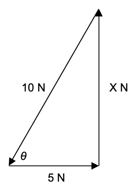

Since you're learning and for future reference.
When ##N## vectors add to zero, they form a closed ##N##-sided polygon, in this case a triangle (figure on the right drawn to scale). Because it is a right triangle, you can find the unknown side by using the Pythagorean theorem $$X=\sqrt{10^2-5^2}~\text{N}.$$Then $$\cos\theta=\frac{5}{10}\implies \theta=60^{\circ}.$$
kuruman said:
View attachment 340154Since you're learning and for future reference.
Nice, i can see that if the ##10## N line is extended to the first quadrant and noting that the angle ##θ## is vertically opposite then we can use your approach.
