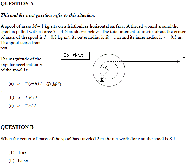

Calculate Torque: Solve the Equation!
  • Thread starter TBBTs
    Torque
TBBTs
http://i.imgur.com/WrwsT.png
Diagram of a spool on a frictionless horizontal surface, shown in top view, with a thread wound around its inner radius r = 0.5 m and outer radius R = 1 m, pulled to the right with tension T. Printed multiple-choice question text sits beside it.
Torque = FR
1) I thought I need two torques because they are in oppsite direction
2) I tried use alpha find acceleration and find angular velocity and K=1/2 I omega^2
TBBTs said:
Torque = FR
What is R in that equation? (Please don't just say "the distance" ... what distance does the R signify?)
No, there is only one torque acting on the spool here. There is no friction, and the normal force does not exert a torque.
You don't need the angular velocity. What is the angular counterpart to Newton's 2nd Law, F=ma?
