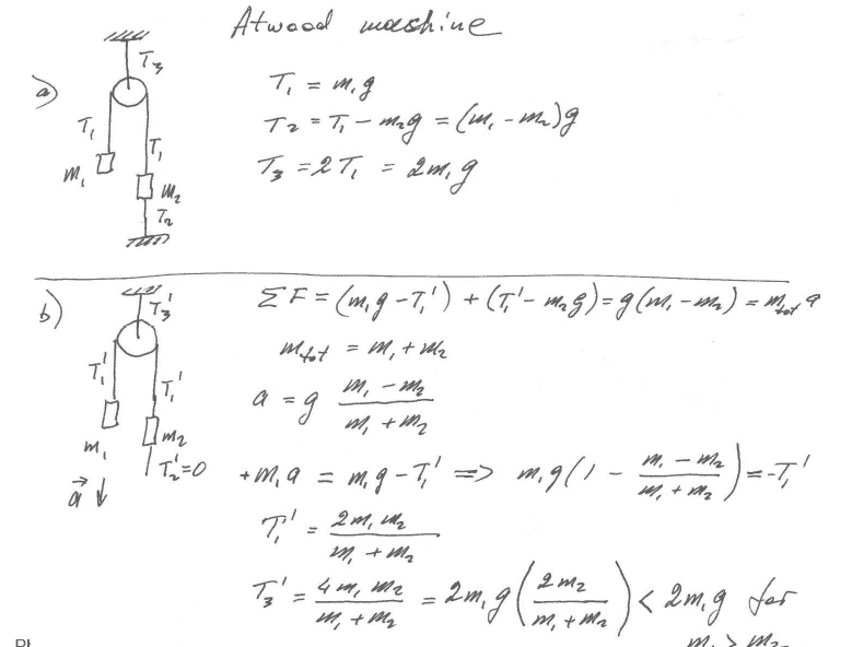

I thought the two readings would have to equal the total mass of the crate? My understanding of pulleys is really lacking, and these notes given to me from my teacher make little sense (he is not the best instructor and has failed to give me a good explanation for them)
Handwritten notes titled Atwood machine, showing two pulley setups: (a) with masses m1 and m2 and tensions T1, T2, T3, and (b) with accelerating masses and tension equations like T3' = 2m1m2/(m1+m2) and acceleration a = g(m1-m2)/(m1+m2).
Those notes don't match the problem you describe. Where the heck did the pulleys come from? According to the question in the OP, there are two spring scales, one aboved and one below. Take away the word "scale" and you have two springs. ONe pulls up, one pulls down. The one above will have to pull up with the force equal to the weight of the crate plus the amount by which the lower spring pulls down.
The notes are for "Atwood's" machine, that's a different problem.
