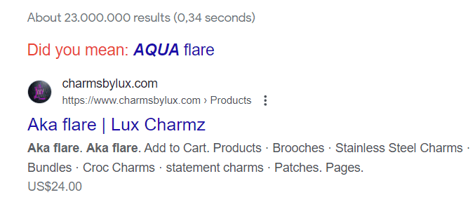

What is an AKA flare ? :smile:

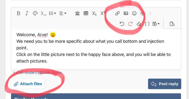

Click on the little picture next to the happy face above, and you will be able to attach pictures.

You know exactly what a 'Flare' is. Lucky man. It's a style for trouser legs (=pants) for me or an explosion on the Sun or landing an aircraft etc. etc.
Many images can just be pasted directly into a post and the 'link' symbol is good for pasting links (EDIT PASTE works too.)
Here we go, thanks Lnewqban for sharing how I can insert an image.

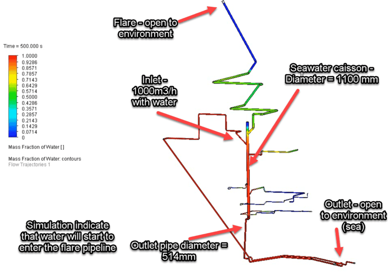

So, a Flare offshore is the pipe network where all the gas is exiting, I have included a photo of a typical Flare.
I have also included an image of the pipe network im curious to where i will have water- The snipp image is from my simulation, where the coloring indicates that I will have some water creeping up in my "Flare-pipe". My inlet pipe is located on the side of the "main seawater caisson" (The large vertical pipe).
Hope this can provide a more clear idea of the challenge - to calculate where the "level of water" will in the large vertical pipe, and if the water will creep up in my flare pipe as indicated in my simulation.

I suppose so. But was disoriented by the liquid context and the AKA epitheton.
@Arve S colorful picture isn't alll too far from what I sketched on the basis of post #1, but there's still a lot to be explained.
Inlet 10 m below top of 1100 mm pipe. Inlet seems to come from lower right, hundreds of meters away, close to outlet open to environment . A pump ? 1000 m3/h 'with water' (and what else?)
One (750 mm) outlet 5 m below top ? The 30 m is what ? Looks more like 100 m to the flare
Outlet to environment ? Air? Water ? Atmospheric pressure ? As @Dullard asks: where is sea level ?
Color denotes mass fraction of liquid water ? What else ? water vapour ? First section (how many m ?? ) of 750 mm pipe is 50% liquid water ?
I suppose pressure drop calculations can be done based on main flow pure water 2.2 m/s in inlet pipe, 0.29 m/s in main pipe (1100mm) and 1.34 m/s in outlet pipe ?
Roughness ?
What is your simulation program called and what is it doing ? You mention t=500 s after what ? start from empty ?

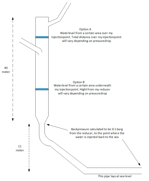

Hi BvU, ineed its as you sketched it.
I guess first of all im trying to understand some simple physics on how the water will react in this open system. I believe we have two options on where the water will "stabilise" in some way when the system is running with 1000m³/h.
Option A: We will achieve a water level (air above) that is above my injection point, some distance, and might even creep in the flare pipe. The distance will depend on the backpressure produced in my system.
Option B: We will achieve a water level some distance over the reducer piece. Where the distance depends on the backpressure produced in my system.
I always believe that the waterlevel would be under my injection point as long as the backpressure generated from my outlet pipe is considered low, however one of my collegue informed me that regardless of the backpressure produced, the waterlevel will always be some distance above my injection point, this as a result of an open system (open to environment both in the top and in the bottom).
So, any idea if this will be true?
Referring to your original question:
Get a smarter colleague (you're right).

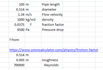

With this calculator I get a pressure drop of 6.5 kPa over the 100 m, 514 mm pipe
Since you have an additional head of 11 m after the reducer, there seems to be no problem.
I also don't understand why your colleague thinks much more is needed.
