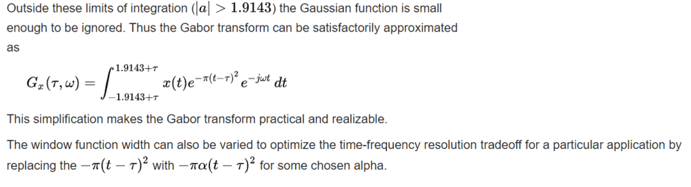

For the sake of completeness (https://en.wikipedia.org/wiki/Gabor_transform):
In our case we have
U_x(\tau \, , \,\omega)=\displaystyle{\int_{-1.9143+\tau}^{1.9143+\tau}}x(t)e^{-\pi(t-\tau)^2}e^{-i\omega t}\,dt )
and I'm a bit confused whether ##t## or ##\tau## is meant, i.e. if we are talking about a simple variable substitution. I assume that the exponent ##-\omega t## is abbreviated by ##\chi## and we have such a substitution of the integral variable. The real case applications of the Gabor transform lives with approximations. So maybe the ##\alpha## in the Wikipedia article can be used to simplify the other terms of the integrand. Or - what could be as well - ##U(\chi)## is a sloppy notation for ##U(\tau,\chi)##.
Thanks, I think that you are right about the notation and the substitution.
