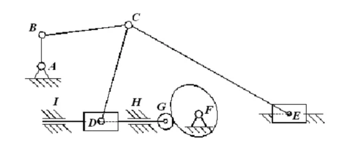

Compute the degrees of freedom of the mechanism in Figure 1, and specify if there are any coincident joints, redundant constrains and idle degrees of freedom.
Gruebler's Equation: 3(n-1) -2 jp - jh
n= total number of links including frame
jp = total number of primary joints (pins or sliding joints)
jh = total number of higher-order joints (cam or gear joints)
Just unsure if I did it correctly. I identified G as an idle Degree of Freedom. Should I exclude it from DOF calculation? But is I do that The Current DOF would be more than 2 which is definitely the wrong answer.
