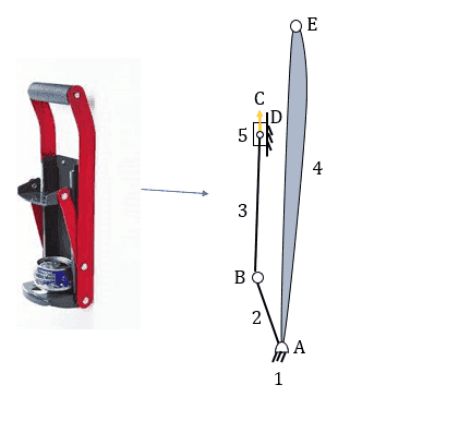

Hi, I'm trying to get the degrees of freedom of a can crusher.
So substituting I get
\begin{array}{l}M=3\left(n-1\right)-2j_1-j_2\\
n=5\\
j_1=5\\
M=3\left(5-1\right)-2\cdot 5-0\\
M=2\end{array}
And I would think it would be 1
Welcome to PF.
It's best to define all of your terms when posting equations. Assuming that this is a standard DoF problem, I think:
M = Mobility
n = Number of Links
j = Number of Joints
Is that correct? Also, did you generate the drawing of the can crusher on the right? If so, could you somehow show what corresponds to what on the picture on the left? I'm having trouble seeing how you came up with it.
I agree that I think this crusher "hinge" has basically 1 DoF, but it would be best to understand your drawing first to be sure. Thanks.

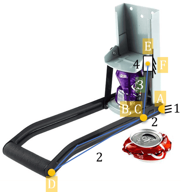

Hi Berkeman, I changed the image and did it above but it doesn't seem to be correct
The original image was this
