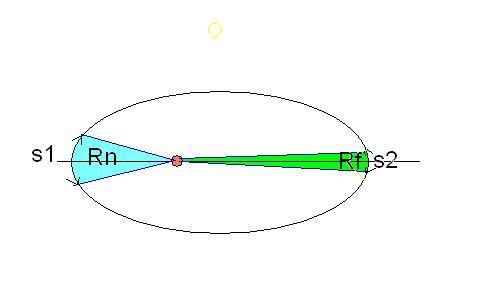

That is it, the second one. What are the areas the line from the planet to the Sun sweeps in one second when the planet is nearest and when it is farthest? For that short time you can consider those parts of the ellipse as they were sectors of circles. How do you calculate the area of a circular sector?

I mean only thin sectors, swept by the radius in 1 second at the nearest and farthest points.
You know that the area of a circular sector is sr/2, where s is the length of arc and r is the radius of the circle. Supposing the speed of the planet is v, what is the length s it covers in 1 s?

I'm sorry guys Idk why I'm having so much trouble with this. Can I use V=D/T where D = s (the distance swept out) and V = the velocity of Earth at whichever of the two points you are looking at. T = 1 so V will just be equal to s ?

Yes, s=vt and t=1. The areas are equal. What relation follows from that between the speeds and distances from Sun?

Don't just guess. Work it out based on what ehild said.
ok so the area of one sector is
[itex]\frac{s_1 R_n}{2}[/itex]
the other is
[itex]\frac{s_2 R_f}{2}[/itex]
the areas are equal so
[itex]\frac{s_1 R_n}{2} = \frac{s_2 R_f}{2}[/itex]
[itex]s_1 R_n = s_2 R_f[/itex]
s1 = Vn and s2 = Vf
[itex]V_n R_n = V_f R_f[/itex]
[itex]V_f = \frac{V_n R_n}{R_f}[/itex]
