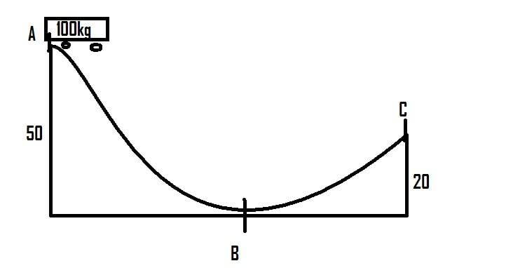

I need to find out the Ek at "B" this is the diagram i got i want to know if its right and if it is why do i use the Height of 50 to find out Ek at "B"
Ek=Ep
Ek=Ep
Ek=m.g.h
Ek=100x9.8x50
Ek=49000J

Yes, that's right! …
(except it's really change in Ek = change in Ep) …
but why were you worried about using 50 for B? :smile:

If I'm figuring out Ek at "B" shouldn't i use the height also at "B"?
The *change* in kinetic energy plus the *change* in potential energy equals zero here: so you do need to use the height at B, or more precisely, what matters is the *difference* in height between A and B.
Probably the picture is badly drawn, I suppose the difference in height between A and B is 50m [the units for height are missing, too].
So i use the Diffrence in height of where it starts and where the point is?
Exactly!
Thank you so much made my Physics work much easier
