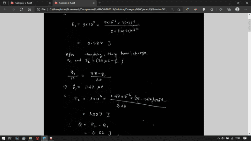

Two solid conducting sphere of radius ##10 cm## and ##20 cm## having ##5\mu C## and ##30\mu C## charges respectively are kept at 2 meter distance. Then, they are connected by a conducting wire. Find the amount of heat generated in this process.
##U=\frac{1}{4\pi\epsilon_0} \frac{q_1 q_2}{r}##
Generally, energy is ##U=9\times 10^{9} \times \frac{5\times 10^{-6}30\times 10^{-6}}{2+(10+20)\times 10^{-2}}=0.5869 J##
<br/>
After touching, they have charges
##q_1 and q_2 = 35\mu C-q_1##
##\frac{q_1}{10}=\frac{35\mu C-q_1}{20}##
I was wondering where 1/10 and 1/20 coefficients come from. I was thinking to convert q_2 to q_1 but end up with nothing.

That's not very general at all. Seems more like an evaluation of ##U## in the relevant equation!
And ##U## is not the only energy in this exercise ! How much energy is needed to charge each of the two spheres ?
Also: after touching, what happens and when does it stop ?

I’ll add a few thoughts in addition to what @BvU has said.
Each sphere acts as a capacitor in its own right. The capacitance of an isolated sphere is as shown here: http://230nsc1.phy-astr.gsu.edu/hbase/electric/capsph.html#c2. After connecting, the 2 spheres are at the same potential. You may now be able to work out where ‘the 1/10 and 1/20 coefficients' come from!

They start with different charges and, more important, different potentials. A conducting wire let's charges move until there is no more potential difference.
So your job in this exercise is to compute the energy of the initial configuration, to find the charge distribution at zero potential difference and the energy of that configuration. The difference must have been dissipated.
