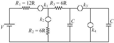

Long time after closing K1,k2 and k3 the energy stored in each capacitor is?
My method is to find out an expression for the current through the capacitor (of net capacitance 2C) at any time t and use I = CdV/dt to find out V across it at t=inf.
However this method appears to be very long. Is there any shortcut?

Yes. At T=inf the current through the capacitors is zero.
Also notice: that will leave you with a fairly simple circuit. The capacitors in combination with R3 are in parallel with R2[/SUB, but the voltage drop across R3 is zero since there is no current through it.
So you mean voltage drop across any capacitor is V ?
No.
As t → ∞ :
The only current flowing is through R1 and R2.
What is the voltage drop across R2?
Its V/3
Thank you!
Abdul Quadeer said:
Its V/3
Thank you!
Correct !
