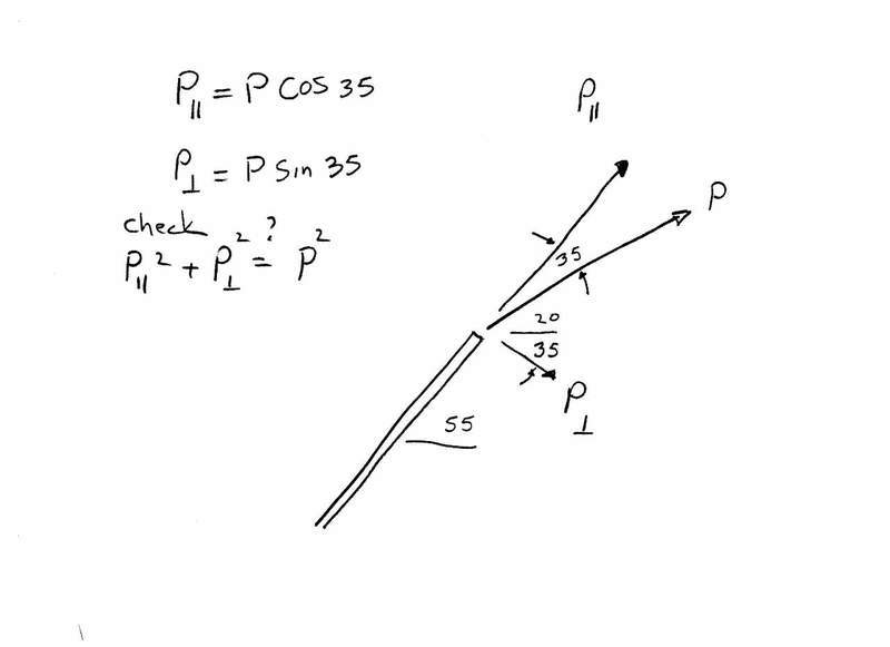

Replace the force for by the equivalent of two forces parallel at the dot and the other perpendicular to the beam.
The force P is 2000 N
Determine the forces!
Fx= P*cos(x) =
Fy= P*sin(x) =
Fx= 2000 N* cos(75)= 0.517 kN
Fy= 2000 N* sin(75) = 1.93 kNAm I on the right track? It's just the angle that I'm not sure about.
Does this look right?
Yes. This looks better. I can't believe i didn't think to check on what Pythagoras thought about my solution.
Thank you!
