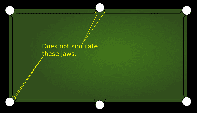

This is working really well except neither the paper nor the FastFiz implementation support or model the jaws of the pockets. Instead a ball is considered 'pocketed' when it enters the opening of the pocket boundary.
I am attempting to include the jaws as shown here:
(I need all the jaws, the image is just to show what I mean by 'jaws')

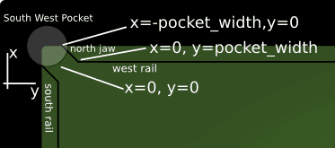

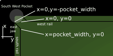

I suppose I should also explain how I see my changes working and perhaps someone might see where I've gone wrong.
Note that the diagrams are basically hand drawn illustrations and are not supposed to be to scale or accurate in any way.
Looking at the east jaw:
and given the equation:
Code:
 numRoots = gsl_poly_solve_quadratic(-0.5 * mu * Table::g * (u_hat.y + u_hat.x), v.x + v.y, -r.x - r.y + cp_width - ball.getRadius(), &root1, &root2);
I'm assuming the only changes I need to make are to the third parameter which I believe is describing the line we want to hit, such that (ignoring the ball radius):
-x - y + cp_width = 0
when x = 0:
-y + cp_width = 0
-y = cp_width
y = -cp_width
when y = 0:
-x + cp_width = 0
-x = -cp_width
x = cp_width
Seems to match the diagram..
Similarly the north jaw:
Code:
numRoots = gsl_poly_solve_quadratic(-0.5 * mu * Table::g * (u_hat.y + u_hat.x), v.x + v.y, r.x - r.y + cp_width - ball.getRadius(), &root1, &root2);
x -y +cp_width = 0
when x=0
-y +cp_width = 0
-y = -cp_width
y = cp_width
when y=0
x + cp_width =0
x = -cp_width
This does not work as expected though.
It seems the maths is correct given my diagrams so I'm left suspecting that I need to make changes to one of (or both of) the first two parameters. But I really don't understand what they represent in terms of this equation and I'm totally lost at what I might do to get this to work.
Any ideas or hints?

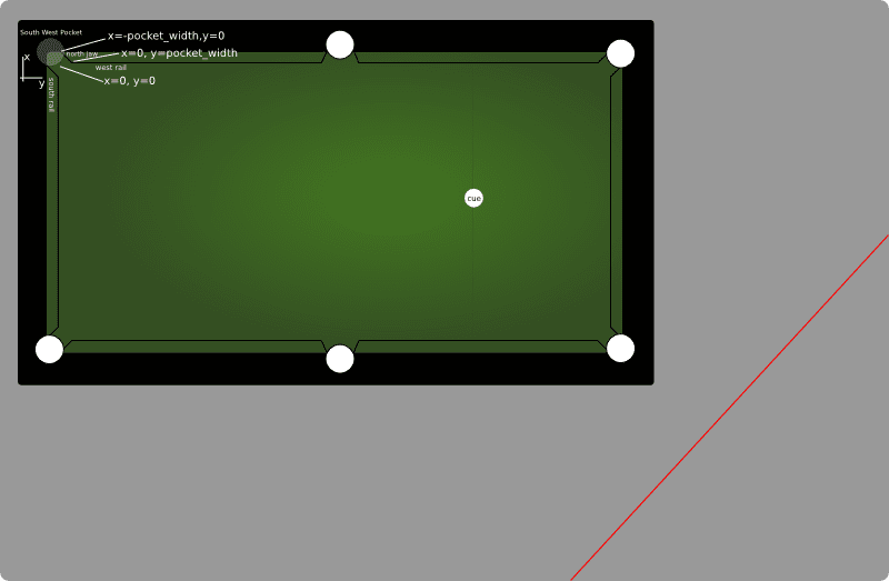

I totally understand - it's difficult to describe. Here is an illustration that shows what I was trying to say:
When the cue ball is off the table as shown, I can get collisions to be 'predicted' near where the red lines are.. I understand this is probably not very useful, but I'm describing what I see visually.

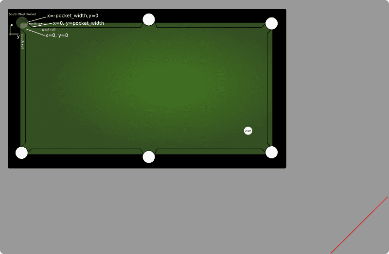

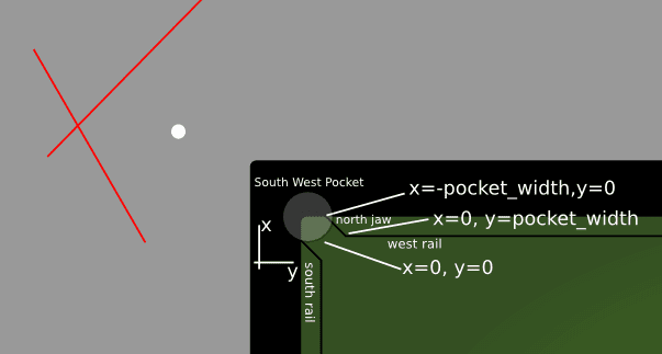

Excellent suggestion (I have no idea why I didn't simplify the problem initially).
So I've removed all except the South West pocket East jaw - no other rails or pockets. I get this effect:
Note how as I move the cue ball the line also moves. The line is showing where a cue ball collision would occur if I aimed towards the red line.
Now if I move the cue ball towards the NE pocket the line moves 'away' from the cue ball
Obviously this is also no where near where the South West pocket E jaw line should be...
Does that give you any hints on what's going wrong?

So I'm still unable to solve this problem. I am a little closer and I have gained additional understanding but still can not find a suitable solution.
I'll see if I can explain what is now occurring.
For the SWp EJ I am now using the formula:
numRoots = gsl_poly_solve_quadratic(-0.5 * mu * Table::g * (u_hat.y + u_hat.x), v.x - v.y, r.x - r.y - cp_width + ball.getRadius(), &root1, &root2);
This is to describe the line (ignoring the ball radius for now):
v1 = x=cp_width, y=0, z=0
v2 = x=0, y=-cp_width, z=0
This seems to solve ok with:
x - y - cp_width = 0
So for v1 when y = 0
x - 0 - cp_width = 0
x - cp_width = 0
x = cp_width
For v2 when x = 0
-y - cp_width = 0
-y = cp_width
y = -cp_width
I have followed mfb's advice and tried multiplying a few values by (1*sqrt(2)) but this doesn't seem to have any influence on my current problems (but may be required once the problems are fixed)..
The equation I ended up with for this line is:
numRoots = gsl_poly_solve_quadratic(-0.5 * mu * Table::g * (1/sqrt(2.0))*(u_hat.y + u_hat.x),(1/sqrt(2.0))*(v.x - v.y), (1/sqrt(2.0))*(r.x - r.y - cp_width_real+ball_radius), &root1, &root2);
Which is possibly not correctly interpreted from mfb's advice. But I'm using the former equation without the 1/sqrt(2) to keep things simple until I find the cause of the bigger issue.
So that's the current state for which I am about to describe the effects I see.
The velocity seems to effect the collision point. With a low velocity the line seems to be much closer to the ball than with a high velocity - this suggests to me that the (v.x - v.y) parameter (which appears to describe the velocity) is not correct for a line at this slope (as opposed to the N,E,S & W rails) is that possible?
Is it possible that the (v.x - v.y) and its variants used are only relevant for lines parallel to the x and y axis? And if so, can this be adjusted to work for a line on a 45° angle like I'm trying?
Another issue (which I think is probably best left until my main issue is fixed) is that the paper that describes this mathematics states:
Since the ball’s position vector r (t) refers to its center, when predicting rail collisions the look for the intersection of the ball’s center and a horizontal line parallel to the rail but one ball radius toward the center of the table.
I'm pretty sure this won't work for that jaw line since the line [STRIKE]actually needs to move out one ball radius on the lines normal which is not towards the table centre[/STRIKE] needs to move some other function of the ball radius (I think, and I'm not sure what it would be). This may also give hints on why this whole approach seems to be failing..
Any ideas?
