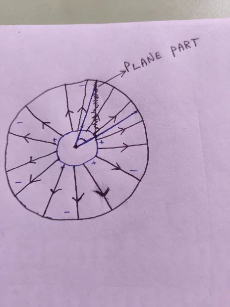

Well firstly as the outer cylinder is grounded, it must have a zero potential. My first doubt is that is it like a capacitor? i.e, will there be any field outside the outer cylinder? If no then how so?
I presumed that it won't have any field lines going out so I only have to calculate the flux through the plane inside the outer cylinder only. Now, since some part of the plane is inside both the cylinders, it must have zero flux as there's no charge enclosed. So I would have to calculate the flux through the two strips which are outside the inner cylinder but inside the outer cylinder. Also the field would be only due to the inner cylinder as the portion is still inside the outer cylinder so no field by the outer one.
Now my second problem is how to calculate the flux. If it were an infinite cylinder I would assume a infinite line charge on the axis of it and simply integrate through the 2 remaining slits slits. But I am unable to do that as I think the stip I'll be choosing would have non uniform field on it so I might have to calculate a double integral which is outside my course.
I've seen some solutions but they do it like it's an infinite cylinder so they just integrate like I mentioned. But I can't seem to figure out if that approach is wrong or not. Also I've seen some solutions calculating the flux with gauss's law, I am doubtful of that too. Can anyone tell me is my reasoning conceptually correct or am I making a conceptual error or maybe missing something.

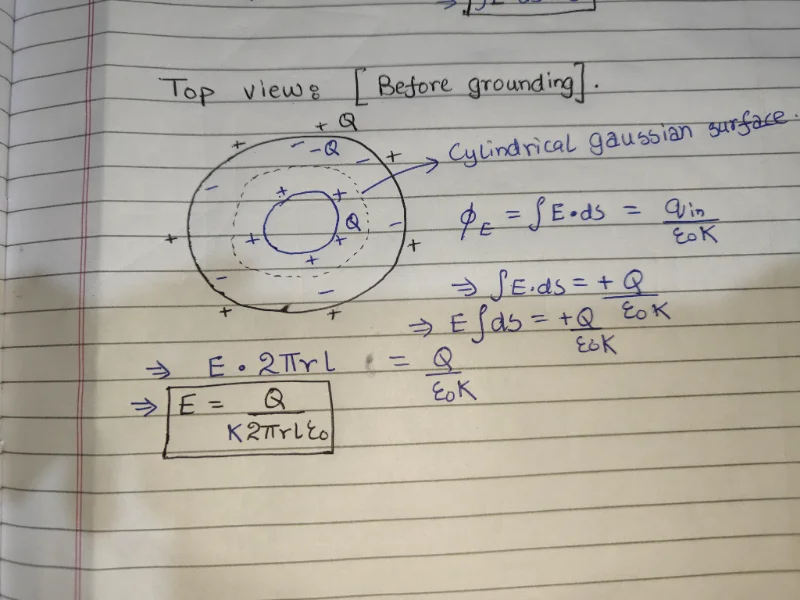

How about using Gauss's Law to calculate the electric field just underneath the surface of the outer cylinder? Set aside the plane the for this calculation and figure out the electric field inside the dielectric. What do you think the closed Gaussian surface should look like?
I take a cylindrical surface as it is symmetric and calculate the field inside the region with the dielectric and it comes out as Q/2πrle⁰k
According to your attachment, this is before grounding . What effect does grounding have on the answer? (Hint - Post #10.)

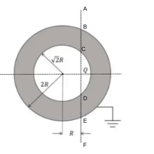

In the following diagram the 'ends' of the plane are labelled A and F. Other important points are marked B-E. A horizontal (perpendicular to plane) line has been also been added in case it might be helpful.
Your are going to have to ask yourself what are the individual fluxes through AB, BC, CD, DE and EF. Then add them. If the electric field is zero in any region(s) this will help a lot!

Zayan said:
Also, note that the derivation for the field is for an infinite cylinder, but the question has given the length l. Nevertheless, assuming it is infinite,
The question specifically says "Ignoring edge effects". So the field from the cylinders of length ##l## is identical to the field you would have from a section of length ##l## of an infinitely long cylinder (with the same linear charge density).
Zayan said:
I can say the flux through C to D will be zero as there is no field inside. The total flux through the plane will only be through the symmetric regions BC and DE.
Correct - providing the fluxes for sections AB and EF are zero. This is the case if all the
outer charge has flowed to ground (so the field outside the outer cylinder is zero).
So now you are faced with finding the (identical) fluxes through BC and DE.

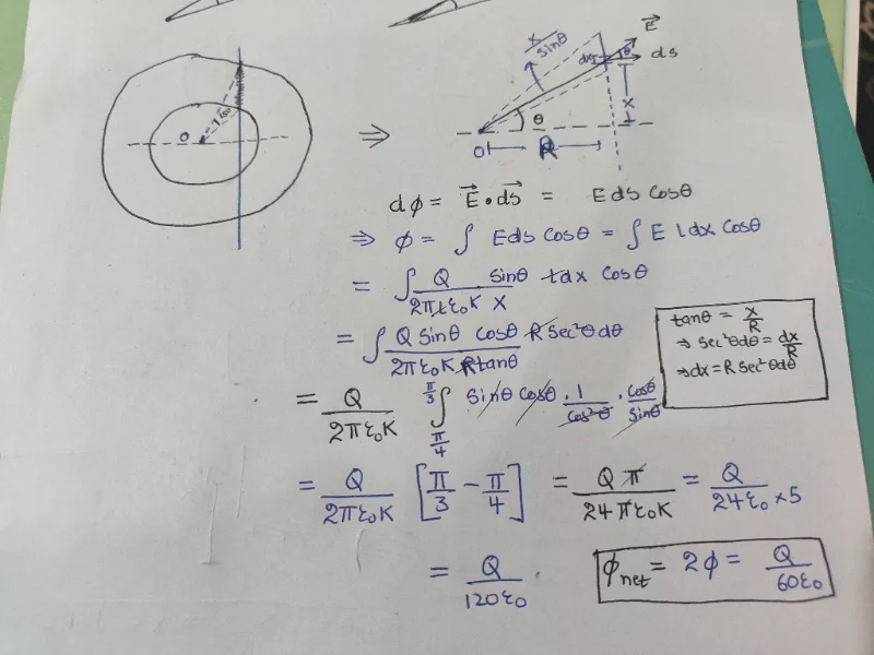

Are you talking about the unitary method? Like dividing total flux in 2π and multiplying by 2*15° = 30°? I don't know I am kinda sceptical about that method. Is that valid? I mean the field is not constant for BC so can I still use that?
Please post a diagram showing the lines of flux through BC.

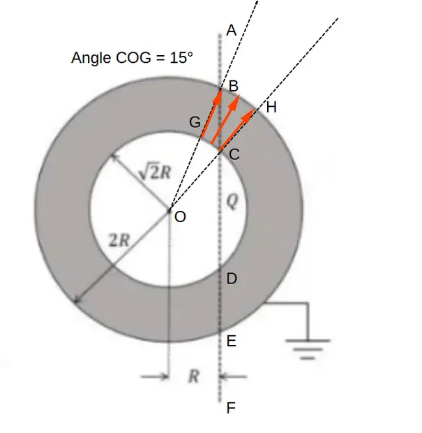

Picture it first without the plane. You have a total flux through the cylinder, evenly distributed around the circle.
In the 2D diagram, draw a line within the annulus from a point A on the outer cylinder to a point B on it. Doesn’t have to be straight. What fraction of the field lines cross the line an odd number of times?
The same number of lines that would have crossed the part of curved surface of the outer cylinder

OK. In case it's not yet clear, here's a diagram showng field lines (in red) in the region of interest:
The amount of flux through an area can be represented visually by the number of field lines passing through the area.
The lines of flux that pass through BC are the same ones that start on arc CG and end on arc BH because the lines are radial. (*See note at end.)
So the flux through BC equals the flux from arc CG. In my diagram this is equivalent to the 3 red lines.
If the total flux from the inner cylinder is ##\Phi## then the fraction of this flux which starts on arc CG (and passes through BC) is, by proportion, ##\frac {15}{360} \Phi##. This is the flux through BC.
*Note: The area in question is actually a rectangular region of the plane with length ##l## and width BC. But is is more convenient to refer to this area simply as ‘BC’. Similarly elsewhere.

check this out
