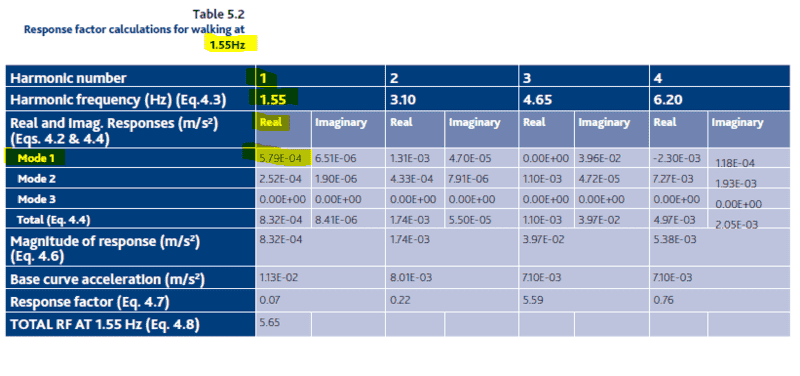

Hey guys. Im about to learn about footfall induced vibration. However i want to reach the same results as in the pdf page 44 ''design guide for footfall analysis''
i get 0.000726 while they get 5,79E-0,4.
Can anyone help me figure out what im going wrong and where i have made a mistake?

  • Table 5.2 of response factor calculations for walking at 1.55Hz, listing harmonics 1 to 4 with real and imaginary responses, mode 1 to 3 values, total response, magnitude and response factor rows.
I'm not sure I get how to calculate the ##\mu##. Otherwise, the only error I can find in your calculation is that ##\zeta_m## should be 1.5%, not 0.9%, but this is not sufficient to explain the discrepancy.
