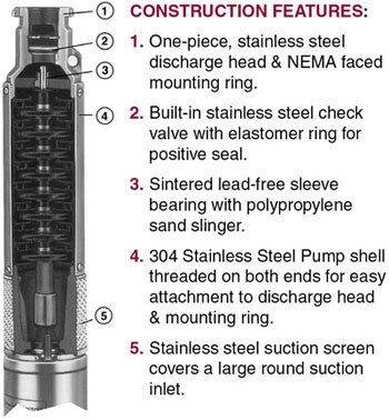

Imagine this submersible well pump pumping water straight up
volume flow 1 liter/second
fluid speed 10m/s
Since pump is pushing on the fluid, fluid has to push on pump as well
Will it be linear vector force downward or torque or combination of both ?
How do i calculate their magnitude?
m1 u1 + m2 u2 = m1 v1 + m2 v2
Also Δp1 = −Δp2
I assume combination of both reaction forces.
Looking at the picture, the pump seems to eject water vertically, from the head located on its vertical axis of symmetry. So I think there is no torque to speak of.
