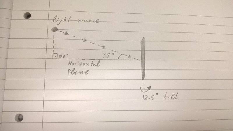

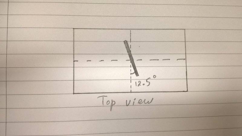

A plate is subjected to rays from a light source located 35 degrees above the horizon. The plate itself is tilted 12.5 degrees around its vertical axis reducing the exposure to the light source.
Find the incidence angle between the light source and the front face of the plate.
I believe the solution is based on trigonometry mostly, but could not sort it out...
Any help or even direction would be much appreciated![/B]
Try making a 3D drawing of the mirror and rays and upload it so that we have something tangible to talk about .
If you can't easily visualise what the problem looks like in 3D try doing some 2D drawings first :
One drawing showing a view broadside on so that the 35 degree angle of the rays is shown correctly and another drawing showing a view looking down from above so that the angle of the mirror is shown correctly .
Doesn't matter if your first tries are not quite correct - we can soon put them right .
I have made two 2D skeches for the above problem, I hope it helps.
Basically the light source is at 35 degrees of elevation to the plate if it was just perpendicular to the horizontal plane. However, the plate is tilted by 12.5 degrees around its vertical axis which changes the angle of incudence.

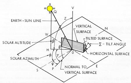

It is also similar to the sketch below but much simpler I assume because we only take into account the vertical plate.
3D diagram of solar geometry showing a sun with the Earth-sun line to a tilted collector surface, labeling solar altitude, solar azimuth, tilt angle, normal to vertical surface, and compass directions N, E, S, W.
Thank you in advance!
  • Hand-drawn sketch on lined paper of a light source above a horizontal plane, with a dashed ray descending at 35 degrees to a vertical plate, labelled 12.5 degree tilt.
  • Hand-drawn top view sketch of a rectangle with a dashed line across it, showing a thin plate rotated 12.5 degrees from a dashed vertical reference line.
Take an origin in the plate, with the X axis parallel to the plate and the Y axis normal to it, both horizontal.
Consider a ray incident at the origin.
If you move a distance y along the Y axis from the origin, how far would you have to move in the X direction to be back under the ray?
How far are you from the origin now?
How far would you have to move in the Z direction to reach the ray?
