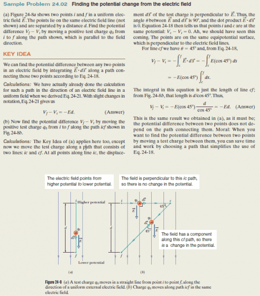

In the problem attached, why is the integral become just the length of line cf?
That result pretty much follows from the definition of a line integral. If you're not familiar with that concept, google will find you some pretty decent explanations.
Note that in part (a) the integral becomes just the length of line if, that is, d.
$$V_f - V_i = -\int^f_i {\vec E \cdot d\vec s}
= -\int^f_i {E(\cos 0^\circ)ds} = -E \int^f_i {ds} = -Ed$$
