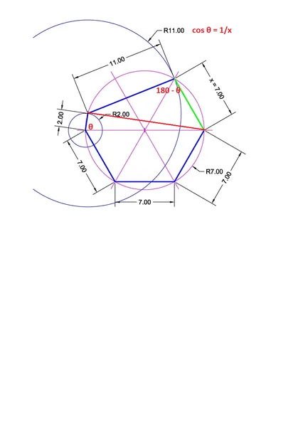

Thanks - just once though! Since one triangle is right, Pythagoras will there suffice.
@neilparker62 My solution with your diagram is simple.
Let RL=red line.
Then ## (RL)^2=2^2+4x^2-2(2)(2x) \cos{\theta} ##
and ## (RL)^2=11^2+x^2-2(11) x \cos(180-\theta)=11^2+x^2+2(11)x \cos{\theta} ##
(both are law of cosines)
with ## \cos{\theta}=2/(2x)=1/x ##
We set the two ## (RL)^2 ## equal to get ## x^2=(2^2 +(2)(11)+11^2)/3=49 ## so that ## x=7 ##.

or ##RL^2 = (2x)^2 - (2)^2 = 4x^2-4##
We can also draw the other diagonal and apply Ptolemy directly:
##2x + 22x = \sqrt{4x^2-4}\times\sqrt{3x^2}=2x\sqrt{3x^2-3}## etc

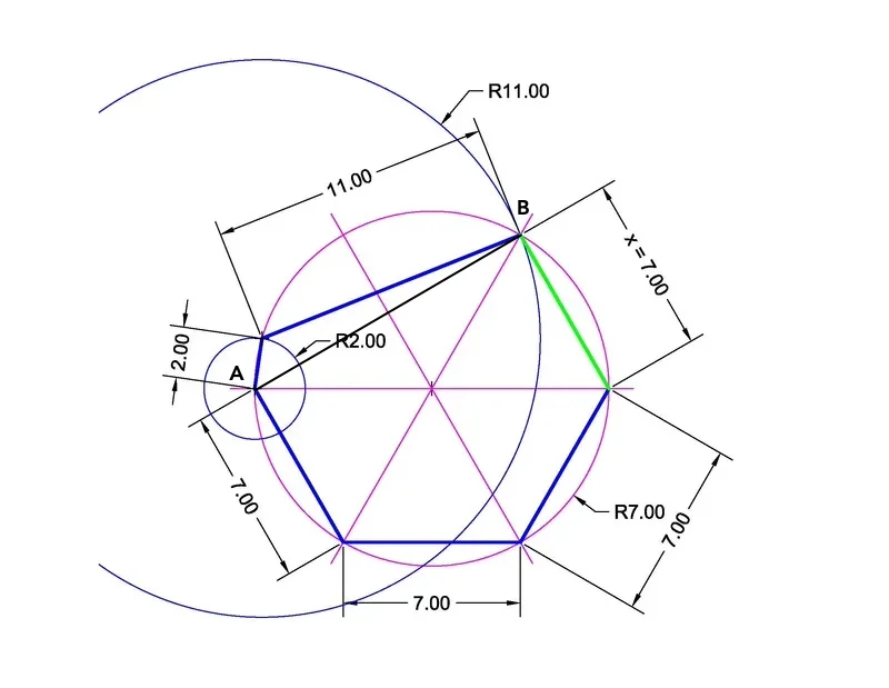

I think the simplest way to get the result is by using the triangle with sides 2, 11, and AB in the modified figure below. The length of segment AB is twice the height of an equilateral triangle of side x, and the angle between the side of length 2 and that of length 11 is ##2 \pi/3##. From the cosine theorem, we get the value x=7.

Definitely the most efficient solution!

I thought @hutchphd 's of post 49, (see also post 52) was simpler. I think this latest (post 73) I would call "a" most efficient solution, but not "the" most efficient. :)
Edit: Notice it does indeed give the general result that ## x^2=(a^2+ab+b^2)/3 ##.

Perhaps worth noting (in retrospect) that you will get this equation directly by implementation of @GiorgioPastore 's suggestion in post #73.

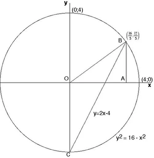

Very interesting discussion on parameterization of this problem. Am still trying to get my head round some of those posts! See also https://en.wikipedia.org/wiki/Diophantus_II.VIII. The technique seems similar.
Edit: Paramaterization solution as per post #46 and solution with m=2.

Yes - as mentioned above the technique is strikingly similar to that employed in Diophantus II VIII which is "to divide a square into two other squares" - I take the liberty of copy/pasting the image from Wikipedia which illustrates the technique when the given square is 16. y=mx-4 is constructed and intersects the circle at the rational point (0;-4). The other point of intersection is also rational and is shown in the diagram with m=2. You might find it interesting to "parameterize" this solution.
As the old saying goes "there is nothing new under the sun" !

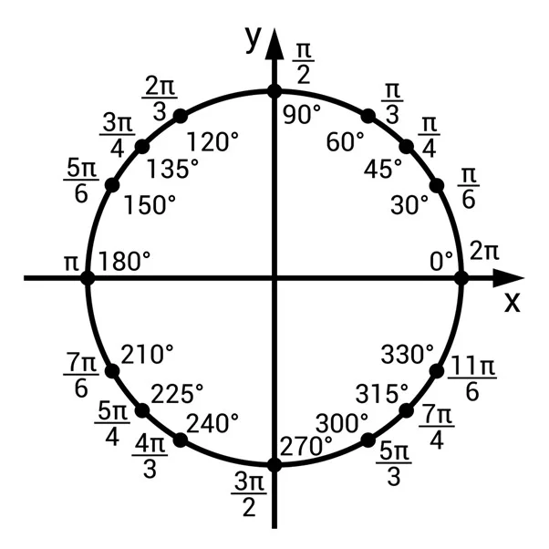

TensorTronic-270 said:
Might help?
Sometimes it's simpler to use degrees rather than radians for the measurement of angles.
Some of it depends upon who the audience is. If you have a construction worker building something, he'll know immediately what a 90 degree angle is, but if you tell him you want it to be ## \pi /2 ## radians, good luck. LOL
