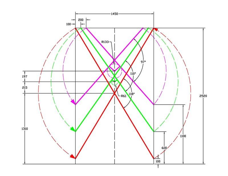

As for a plan view or an elevated view. This is a 2d rotational model I've been asked for help with. My friend believes they have other working models which they use to test things before furthering development but I'm being given limited info here
  • #33
Here's another photo showing just the arcs and there limit. It does not show the entire circle. Just the arcs the lines will follow
  • #34

The view we are seeing is a side view. The reason they won't hit each other is that they won't do a full rotation around the axis. I've simply put the circles on as I was trying to visualize it.
The links will not collide as they will be directly attached to the rotating lines.
Following your last dimensions, I have done this drawing at scale of what I understand.
Please, correct any error, and I will happily fix it.
Note that the two upper doors will need brackets (perpendicular offsets of 61 and 133) to reach the actual point of rotation for each of those.
The attached PDF file shows the drawing with better quality.

Hi thanks that's actually spot on.

It is now late at my corner of Earth, but try finding points with common tangential velocity at each gate, in a convenient location, and connect those with a single link.
You can use the measured angles for that.
It is also important to consider the thickness of each gate, because different points hit the top and the bottom limiting surfaces.
A rectangle does not behave an ideal line in that case.

There are multiple solutions based on where you attach the first connector.
I have some answers here to the original question, but I have not yet verified them.

I think I've managed to brute force a correct answer just by setting a constant and then guessing using an excel sheet.

No collisions, but doing a lot of work based on unreal center-lines, is what worries me.
For example, we are assuming that the represented center lines are hitting the top surface at certain angle, but if you consider the actual thickness of one gate, its top edge will hit that top surface short of the considered angle (based on the that ideal center-line).
I am sorry, I am probably not being able to explain myself properly with words (English is not my native language); that is one of the reasons I prefer showing my ideas in the form of diagrams or scaled drawings.
In CAD, you could create an array of opening positions simply by dividing each arch in several equal portions.
That may help you visualize what points at each gate is more suitable to locate the links.

Ah I follow I think. Yes I understand the concern.
The centre lines are just the basis here and its mainly just to help describe the formula and calculations I was looking for.
This likely won't be put into production but was a test case to help us explore 4 bar linkages.
If we were actually going to create this we wouldn't use centre lines outside of initial drawings.

Given the simple problem, without offset centres of rotation.
For red, green and blue lines.
The independent connector links are shown in magenta and yellow.
Red pin is 476.815 from red centre.
Green pin is 500.000 from green centre.
Blue pin is 544.910 from blue centre.
Red to green link length is 323.914
Blue to green link length is 544.910
