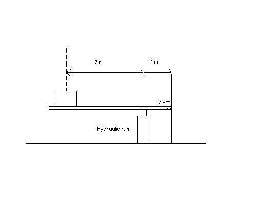

The crates( one create 500 kg) are placed on a hydraulic lifting beam:
1. State the order of lever used here
2. Calculate the effort required to lift the load
3. Calculate mechanical advantage for this system
4. Calculate the velocity ratio for this system. If the work put in is 5000J.Calculate the useful energy output.
5. System has efficiency of 80%. Calculate the velocity ratio for this system.
1. Only class 1 and class 2 levers can be used to gain mechanical advantage
2. large distance x small effort = small distance x large load
3. Mechanical advantage = load/effort
4. Velocity ratio = distance moved by effort/distance moved by load
Efficiency = output/input
5. Efficiency = mechanical advantage/velocity ratio
1. First order?
2. effort x 8 = 500x9.81x7, effort= 34335 N ?
3. ?
4. ?
5. ?
I hope to get any idea to solve them or help me to solve anyone
I'm looking forward to get yr help
