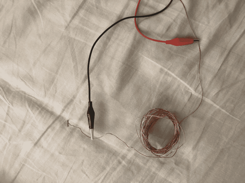

What the actual project was about, was to calculate the force that eddy currents apply on a magnet falling through a copper coil. This is where we made some corrections:
I realized that this was a more complex task than I thought, so the goal was to create a mathematical model for the Magnetic Force acting on the magnet, as a function of velocity.
I still don't know if this force is even noticeable in a coil, so I am not sure if this model can also be used for a tube let's say?
I would calculate the Forces for many different numbers of magnet that I let fall, by putting them into a small object where I can keep the weight constant as @kuruman suggested in a previous post. I would probably aim to test this mathematical model doing some sort of experiment. This would then be a theoretical project as opposed to an experimental one.
Please tell me if this is what you need to know, or if there is anything I should elaborate on. I am also open to suggestions for improvement.

Would this model work in some way for a loop like showing in the picture? I know this model is made for one loop of a coil, but would that also work for this ??
I have connected it to an ammeter and have found that by dropping the magnet through it there was a noticeable current induced.
I think I could perhaps make an experimental part to this and then do the theoretical part using the model @Delta2 suggested.

How exactly do you calculate Bo ? Is it just simply the formula for magnetic field strength B=μoNI / L ?
##B_0## is the magnetic field strength at the surface of the magnet, it is not the magnetic field of the coil due to the induced current.
