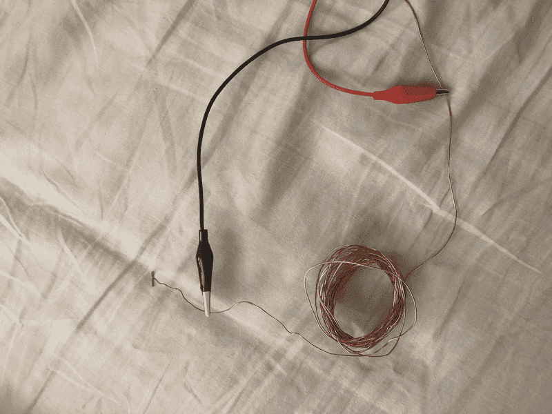

I want to find out the force that eddy currents apply on a magnet that is moving though a copper coil. I have not been able to find out how this works, although I know hoe to find the magnitude of the induced current occurring from the change in magnetic flux using Faraday's Law.
Emf = -N dΦB/dt
This is Faradays Law I used to find the induced EMF.
How can I find out its effect on the magnet itself?
I have jus thought about how maybe I could sue the magnetic field strength equation for a solenoid (that I used to find the Emf in the first place) again, to find the magnetic field strength arising from the induced current:
B= μNI / L
where μ is the permativity of free space
N= Number of turns in the coil
L = length of the coil
Here I could just plug in the newly found Current using the calculations from before when I found the EMF and then plugged it into the equation I=V/R. Would this work? And if so, how does this even tell me what the force acting on the magnet is? Is there any way to calculate this?
You cannot use the solenoid formula because the induced currents are (a) not uniform (they depend on the position of the magnet) and (b) do not flow in the same direction. See
https://www.physicsforums.com/threa...e-process-occur-visually.999296/#post-6452919
for a qualitative explanation of what's going on. If you use a copper tube (continuous coil) that is long enough for a strong enough magnet to reach terminal velocity inside the tube, then a good estimate for the size of the magnetic force is the weight of the magnet (neglecting air resistance, that is).

Thank you for your reply. Although I need to do some further research to grasp this better, as I always encounter different equations for everything, making this fairly complicated.
This is actually for a physics project I am currently working on (for school), so there is no homework statement to this and yes maybe this should be moved to classical physics (my bad), I am new on here and did not know where this corresponds.
What I am exactly doing, is I am trying to find the effect of eddy currents on a neodymium magnet moving (or falling) through a coiled up copper wire. I am trying to find out exactly how much braking force due to eddy currents acts on this magnet by doing the calculations. (which has turned out more complicated than I thought, with all the different forms of Faradays Laws and the Maxwell equations to find the induced emf, and then find out how to calculate what the actual braking force these eddy currents create on the magnet(s).
A few random thoughts in random order...
Is the coil closed - i.e. are the 2 ends of the coil joined together? If not, you will probably not be able to detect any effects at all.
Is the wire insulated? (If not are the coils touching? - if they are touching and uninsulated, the wire is not acting as a coil.)
What are you actually going to measure?
The effects you are trying to detect are small and the experiment would usually be conducted using a thick hollow copper tube to make the effect larger as noted by @kuruman. So you are making life very difficult for yourself by using a coil.
An ‘eddy current’ is a term used for an induced current loop in conductor such as a block of metal. The term eddy current is generally not used for the induced current around a coil.
Calculating the magnitude of the force would be a hugely complex task – the force will be a complicated function of many variables such as the speed of magnet, the shape and orientation of the magnet, the strength of magnet, the geometrical arrangement of the individual turns of wire in the coil, the length and diameter of the wire and the resistivity of copper Calculating the force as a function of these parameters is simply not feasible.

I assume this is a theoretical (as opposed to experimental) project. You will have to make assumptions and approximations and even then it may not be an easy problem. For example, you can approximate the magnet as a magnetic dipole which will give you a (relatively) simple expression for the magnetic field.
Then you drop this dipole along the axis of the coil (z-axis). At this point, you will have to
1. Find the z-component of the magnetic field at an arbitrary point on the face of the coil, ##B_z(\rho,z)## in cylindrical coordinates.
2. Integrate to find the magnetic flux through the coil, ##\Phi_M (z)=\int B_z(\rho,z)~2\pi \rho d\rho.##
3. Calculate the induced current using $$I(z)=\frac{1}{R}\frac{d\Phi_M}{dt}=\frac{1}{R}\frac{d\Phi_M}{dz}\frac{dz}{dt}.$$Now comes the fun part. You should probably consider a very thin loop of a single turn. Then you will have to
4. Calculate the force on the dipole using ##\vec F_M(z)=- \int I(z)d\vec l\times \vec B##, where ##\vec B## is the total field, not just the z-component.
5. Solve Newton's second law equation $$m\frac{d^2z}{dt^2}=mg-F_{M,z}.$$This last equation assumes that "down" is positive and that there are no lateral forces by symmetry.
6. Once you have the solution ##z(t)## you can easily figure out the magnetic force acting on the magnet.
The whole calculation is a tall order, to say the least. It's the way I would try doing it, but only if I had to, e.g. if my dog's life depended on it.
