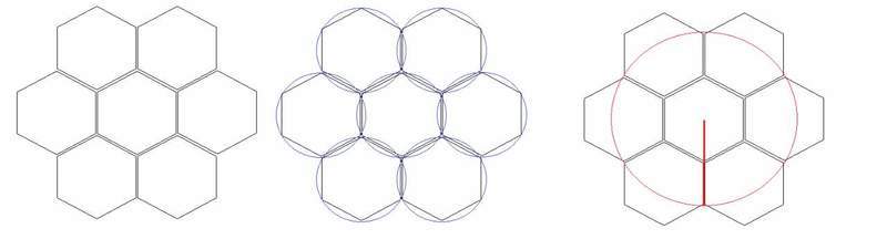

A radio tower broadcasts within a 50 mile radius. At a minimum, how many such towers are needed to completely cover a 100 mile radius?
To simplify the problem geometrically:
Consider a disk with a 50 centimeter radius. At a minimum, how many such disks are needed to completely cover a disk with a 100 centimeter radius?
The area of the larger disk is four times the area of the smaller disk. So this is a lower bound. But this is not achievable. We need to look for a tighter lower bound.

The answer is 7. Think of them as regular hexagons rather than circles, and it should be obvious.

Haha, Ben Niehoff has it right.
As I correctly pointed out, it takes EXACTLY 6 of the smaller disks to cover the boundary of the large disk. Ben Niehoff, however, realized that this implies that hexagons inscribed into the smaller circles still cover the boundary of the larger circle. (You can work this out with a bit of geometry). Then, because of a special property of hexagons, this implies that it only takes one additional small hexagon in the center to cover the entire disk.
If we then consider the circles which circumscribe those hexagons, we see that they have exactly the properties required. Look at this illustration:
You can see that the red circle has radius exactly twice that of the blue circles.

Eloquent answer klackity.
Great visuals, klackity. I appreciate your setting me straight. Yours may well be the most efficient example.
