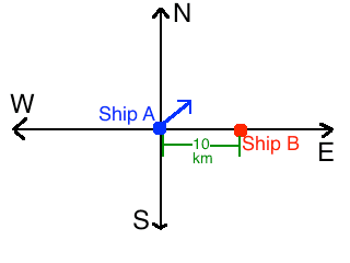

2. (a) is the question I'm stuck with
I know that 3m/s is the Velocity of the man relative to the water and the Velocity of the man is 8m/s and is represented by the vector pointing in the direction theta downstream but I just can't get my head around this question, probably something simple that's alluding me! I have part (b) completed and it is meant to be the more difficult of the two.
I've attempted to add the vectors via triangle law but I can't seem to get it right my vector triangle always ends up having the hypotenuse as one of the shorter sides, any help would be appreciated!

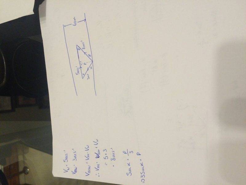

I just realized what I was doing wrong, but I'm still not finished the question, here's what I have so far
Here you go! :)

You can only add the magnitude of vectors if they are in the same direction! Add them component by component.

turns out I didn't do part b correct, any pointers?
The shortest path is when θ is largest.
(Ideally we would want θ=90°, but this can't happen because even if the person swam directly against the current, they would still be moving downstream.)
Do you know how to find the maximum θ using calculus?

If the two boats crash, then they will have the same position at the same time.
Right now, the boats are at the same position along the North-South axis.
In the future, (when they crash) they will also have the same position along the North-South axis.
So what do you know about their North-South velocities?
ahhh, the N/S velocity of A is 5j and the N/S velocity of B is 0j as it travels along the west-east axis
But if B travels along the E/W axis, then will they ever crash?
Remember, the problem does not give a direction for boat B, you can make it whatever direction you want!

But the question states that Ship B is 10km due east of A when t=0 so they can't be in the same position along the N/S axis because that would mean that B would have to be either 10km due north or due south of A for this to be true?
"Position along the N/S axis" corresponds to what most might call the "y-coordinate" and it is the same for both ships:

Think I have it, the minimum value of the j (vertical/y component) is 5j (5km/h) and if the value of V=6 then the directions of interception are due north and N6.59degreesW
If it is going due north at 6 m/s it will go too far and not crash. You want the Northern component of velocity of B to be 5m/s then it will always eventually crash (with one exception) because they will always have the same N/S coordinate.
by intercept in the question I think they mean when ship B crosses the path which ship A is taking, in the case of a collision or going to take in the case of an interception? because 2.(b)(ii) asks that if v=6 show that B can travel in either of two directions to intercept A and find these directions.
The minimum value asked in part (i) is when they will collide but in part (ii) they are referring to the ships crossing paths I believe?
I doubt it. If this is what they mean then there are infinite different directions which ship B could travel. But to crash, there are exactly 2 angles which it can travel.
