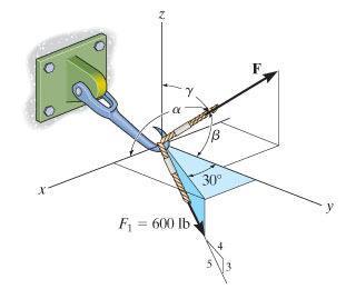

1. If the resultant force acting on the hook is FR = <-180, 810, 180> what is the magnitude of F?
2. So basically i got F1 which is <240,416,-360> and subtracted this from FR and got vector F2 then i took the square of the components and square rooted getting 789lb. Why is this wrong? what am i doing wrong?
3. Please tell me why i got the wrong answer it should be right

Hi Luongo! :smile:
I get 789 also. :redface:
(Are you sure it's 810 for FRy? It doesn't look like that in the diagram)

Tell us how'd you get F1_x and F1_y!? :rolleyes:

to get those two i got F' which is the angle perp to the F1_z component then used that as a coefficient

Yes it's right, i got the units wrong...? DAMN MASTERING PHYSICS! crap... lol
