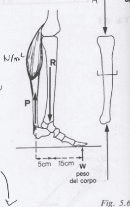

"A 70 kg person stands on the tip of the foot. Assuming a configuration as in Figure 5.6 calculate a) the force P exerted by the tendon; b) the resistance R acting on the tibia; c) the percentage deformation of the tibia, assuming that the section of the tibia is 3.8x10-4m^2 and the Young's modulus is Y=1.6x10^10N/M^2"
This is the image 5.6

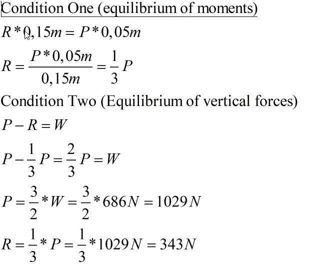

This was my reasoning:
I first calculate the weight:
2 W = m* g = 70kg *9.8m/ s = 686N
Remembering that a rigid body is in equilibrium when the results of forces and moments are zero, I write the following conditions:
P is congruent with the result of the exercise, instead R is different; the exercise results in 1372N which by my reasoning is impossible.
What am I doing wrong?
To calculate point c) I would have to apply Hooke's law which depends on the value of R, and of course this result is also wrong.
Both equilibrium equations seem wrong. Think again and use the force convention from the diagram, where all 3 forces are the ones acting on the foot.
For the moment equilibrium on the foot:
What pivot did you choose?
What are the lever arms of each force around that pivot?
Which forces produce clockwise and which counter-clockwise moments?
For the force equilibrium the foot:
Which forces point up, which down?
Assume standing on the tip of one foot, not two.
70 kg supported by the toe, W = m⋅g = 70 * 9.8 = 686 N.
The bottom of the tibia is a fulcrum.
Torque about fulcrum is zero; P * 5 cm = W * 15 cm ;
P = 686 * (15 / 5) = 2058 N.
R = W + P = 2058 + 686 N = 2744 N.
Yes, though taking the toes as the axis is also valid. But then the equation is R*15cm = P*(5+15)cm. The OP seems to have been inconsistent about the choice.
