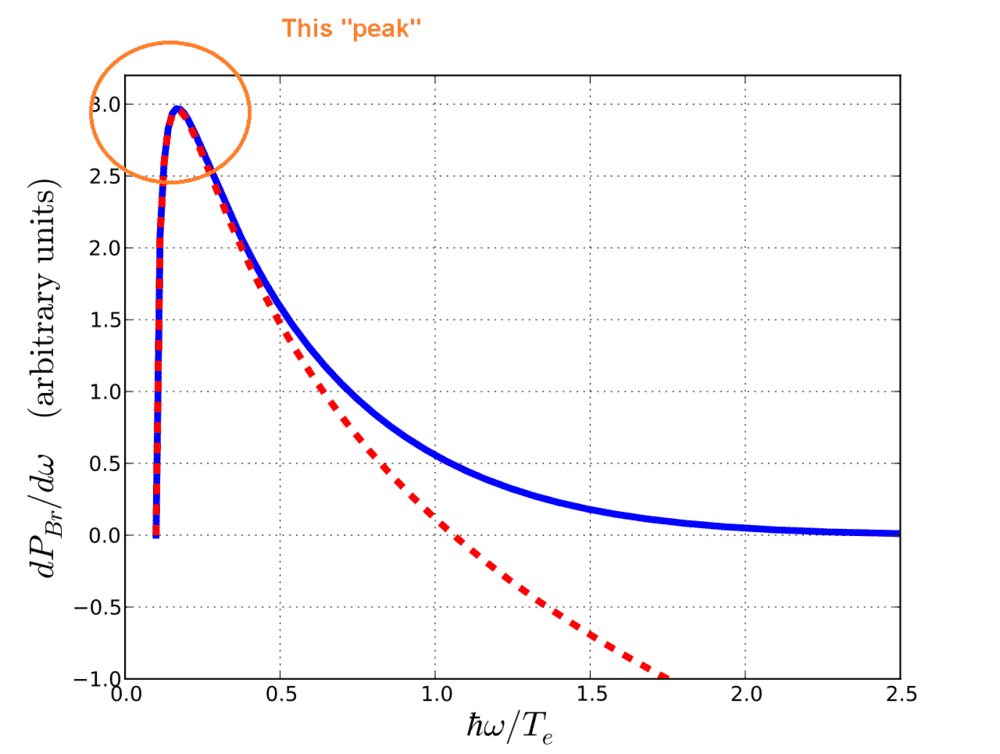

Bremstrahlung has no peak. The characteristic x-ray are dependent on the anode material typically Tungsten which have characteristic x-rays between about 60 and 70 keV.
By peak I mean this peak in the graph. Excuse me if there is a specific term for it.
Where this peak is, and where the maximum photon energy is, is dependent on the setup of the electron gun, in particular the driving voltage.

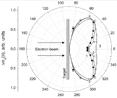

3. Is the emission from the tungsten target isotropic? I don't think it is, in which case the inverse square law, even if it does apply, would have some anisotropy to the intensity as well.

  • Line graph of dP_Br/dω (arbitrary units) against ħω/T_e from 0 to 2.5, with a blue solid curve and a red dashed curve rising sharply to a peak near 3.0 then decaying toward zero, the red curve falling below zero.

I found a plot of the emission of X-Rays from a tungsten target with angle...
Ref:
Electron range evaluation and X-ray conversion optimization in tungsten transmission-type targets with the aid of wide electron beam Monte Carlo simulations
Oct 2014
DOI: 10.13140/2.1.3991.7125
Soffienko, A., Jarvis, C., Voll, A.
