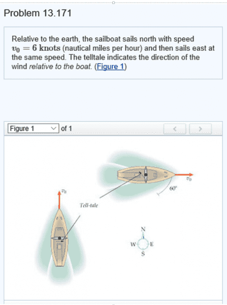

Diagram of two sailboats in a textbook problem: one sails north with velocity v0 pointing up, the other sails east with v0 pointing right, a telltale shown, a 60° angle marked, and a compass rose labelled N, S, E, W.

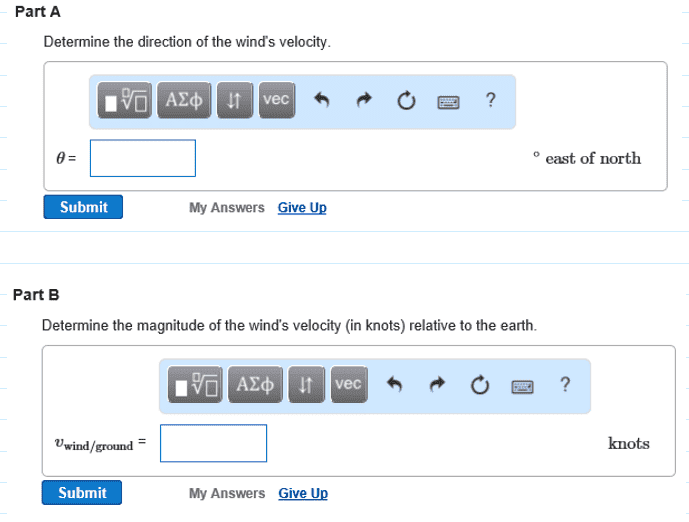

Two Mastering-style answer input boxes: Part A asks for the wind's direction θ in degrees east of north, and Part B asks for the magnitude of v_wind/ground in knots, each with a Submit button and math toolbar.
v_theta = r * theta_dot
1 knot = 1852 m
v_0 = 6 * (1852m/h) * (1/3600 h/s) = 3.087 m/s
It looks as if the first picture is telling us that the apparent wind is from the W and has a zero N-S component. So the actual wind must have a component equal and opposite to the boat speed, 6 kt blowing from the S.
In the second picture, the tell tale is responding to 6 kt actual wind from the S, and is feeling 3 kt apparent wind from ahead (6 cos 60). So the
6 kt wind created by the boat's motion is being reduced by an actual wind of 3 kt from the W.
Combining these two pieces of information, the actual wind has a component of 6 kt from the S and 3 kt from the W. So a triangle of velocities will give you the answers.
