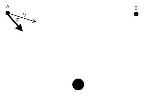

I'm working on an informatic project where there is spaceship and other bodies in space.
I'm searching for a way to my spaceship to calculate an itinary between two points in space. I know how much my spaceship can accelerate (my reactors has an acceleration of Rx, Ry and Rz) and i need to calculate when and where i need to accelerate or decelerate it to go from one point A in space to another point B.
My spaceship have already a velocity preset and a constant force toward the nearest star !
I didn't find the answer by myself so i thought maybe some of you would know how to do it or maybe you can give me some hints on the web !
Thanks !

The question is vague, you might want to draw a diagram or something, is point B the star you're going to? Or are you moving through space from A to B with the star nearby? You can draw a crude diagram in paint or something so we can conceptualize the problem.
Ok so here is a diagram !
My spaceship is at point A. It needs to go and stay at point B but it has a velocity of V and an overral force of F applied to it (by the nearest star)
Its reactor only provide a maximum acceleration of R (in Newton).
How can i go to point B in minimum time using the reactor ?
  • Diagram of a spaceship at point A with velocity arrow V pointing right and a thick force arrow F pointing down and to the right, a large black circle below as the star, and point B at upper right.

This is a very hard problem that lacks any analytical solution. googling for "minimum time orbit transfer" will get you some articles, such as
http://www.dept.aoe.vt.edu/~cdhall/papers/AIAA-4125-357.pdf
and also some MATLAB packages
Thank you Willem ! I will look into it and try to make my way out of this !
