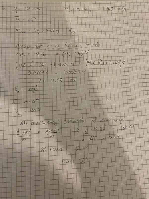

A 0,47 g lead bullet moving at 151 m/s is stopped in a block of wood. All of the kinetic energy goes into heat energy added to the bullet. The initial temperature of the bullet is 32 degrees C. What is the final temperature of the bullet in degrees Celsius. The specific heat of the bullet is 130 and the mass of the wooden block is 5 g
Mv^2/2
I think that the kinetic energy is equal to heat right. Mv^2 / 2 = ms delta T
Delta T is 0,64
But I don’t really know if the temperature decreases or increases at the end

Is that the whole question? Is there a diagram that shows whether the block can move or not?
Are you sure that the mass of the block of wood is not ##5kg##?
You might want to change the title from "Physics" to "Bullet and Block problem".
Yes, the mass of the wooden block is 5 g NOT 5kg.
There is no diagram but the bullet get stuck in the block so it’s an inelastic collusion I think. I’ve calculated the velocity of both bullet and block and got 12.97 m/s
I don't know that I would trust ##5g## of wood to stop a bullet. The ##13m/s## might be right (assuming the bullet does stop) but it is still quite fast.
if we assume that it’s correct, the question would be if the temperature of the bullet increases or decreases at the end? The temperature difference is 0,64. So should the temperature of the bullet be 32.64 degrees Celsius or 31.36 Celsius?

The temperature increase must be much greater than that.
Hmm what have I done wrong? 🤔
It's hard to say since you haven't shown your working.
avinhajo said:
5.3 J?
That sounds about right. How does that translate into a temperature increase?

You must have understood something to compute a temperature increase of ##0.64K##.
Kinetic energy = heat energy?
Is it 5,3 = ms delta T?
I assume this should say "All of the lost kinetic energy goes into heat energy added to the bullet. "
Oooohhh I see. Thank you so much 🙏🏼
avinhajo said:
Is it 5,3J = ms delta T?
Yes, so let's see the calculation. I assume ##s = 130 J kg^{-1}K^{-1}##.
