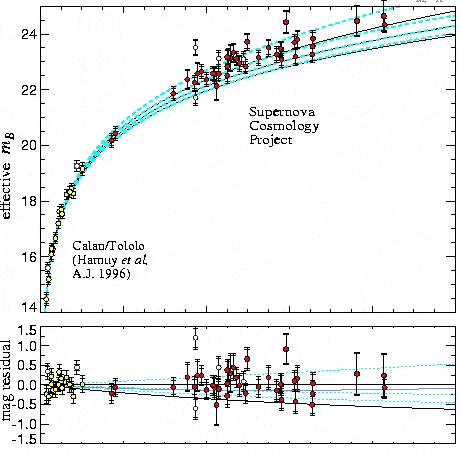

Found this :
I think I will explore this website a bit, looks like this could be just what the doctor ordered.
http://www-supernova.lbl.gov

What is "effective [itex]{ m }_{ B }[/itex]" in the plot, "Magnitude"? If so what does the subscript [itex]B[/itex] denote? The residuals are w/respect to the fits obviously, which look like log fits to me. Gotta love the data. X-axis would then be... estimated distance?
This plot is a teaser : ) I think mb is indeed (some version of) magnitude but I haven't checked yet what exactly it represents. I'm kinda hoping x-axis is redshift for if it is, then this plot is close to what we re looking for.
Now the good news is, the data is indeed available on that site, in plain downloadable ASCII table form.
http://supernova.lbl.gov/Union/ has lots of resources, and it seems the data we seek is here :
http://supernova.lbl.gov/Union/figures/SCPUnion2.1_mu_vs_z.txt

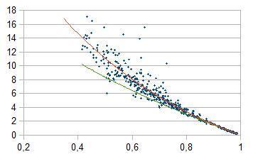

It turns out the age of the universe is between 5 bn years and infinity :wink:
Assuming I read the SCP data correctly, after trying a couple basic fits it appears the extrapolation is clearly too big a factor, and the data too noisy, for this "model free" approach to produce a quick and dirty plausible estimate. Of course more sophisticated methods work, but then this is well beyond this modest attempt.
But it was instructive to try :)
@marcus or someone else around here, I suspect I'm misinterpreting the data http://supernova.lbl.gov/Union/figures/SCPUnion2.1_mu_vs_z.txt and/or missing something before that.
They describe it as "Redshift, Distance Modulus". For the latter I was assuming
a) this translates into a distance ##d_L=10^{1+\mu/5}## in parsecs;
b) ##D=d_L##
But this doesn't fit any plausible FRW model.
Using instead
b')##D=d_L/(1+z)##
Seems to work.
This seems related to a correction I saw mentionned elsewhere to the ##L\propto 1/D^2## law I was assuming above, which appears to be incorrect.
My understanding now is that the number of photons on a sphere is ##N\propto 1/D^2## but ##L\propto N/(1+z)^2\propto 1/(D(1+z))^2## so that the relation b' above makes sense.
Is this correct? Thanks.
With the corrections above, this is what I get with the Union dataset, fitting a FRW matter-lambda D(a) function;
The chart is D vs a; the lower curve is matter-only with a ##H_0=0.070## best fit to low-z supernova, and the second curve keeps that same ##H_0## and a best fit ##H_{\infty}=0.059## (which gives ##\Omega_{\lambda}=0.71, \Omega_m=0.29##).
The corresponding age is then ##T_0=\frac{1}{H_\infty}\tanh^{-1}(\frac{H_\infty}{H_0})=13.9 Gy##
On the other hand, a "model-free" fit using, arbitrarily, a quadratic polynomial in a, while almost as good on the data, yields an age of 6 Gy only.
