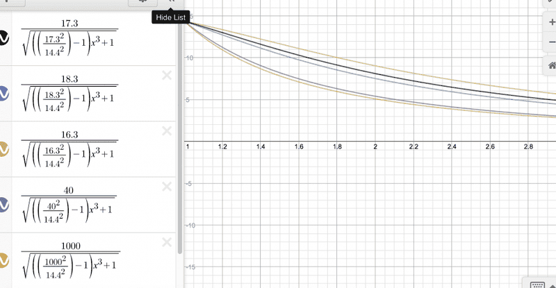

The approach to explaining/learning cosmology that I want to explore here assumes a basis in redshift-luminosity observations or in other words wave stretch (s) and distance (D) data. That was how Hubble originally determined Hnow the present-day ratio of expansion speed to distance.
One way to express Hnow is 1/14.4 ppb per year. It's a fractional growth rate. there are other equivalent expressions.
The same basis of stretch-Distance data vastly improved was used around 1998 to determine H, now estimated at around 1/17.3 ppb per year. I'll try to suggest the rough outlines of how that was done, and fill it in later.
$$H(s) =H_\infty \sqrt{((H_{now}/H_\infty)^2 - 1)s^3 + 1} = H_\infty \sqrt{((17.3/14.4)^2 - 1)s^3 + 1} $$

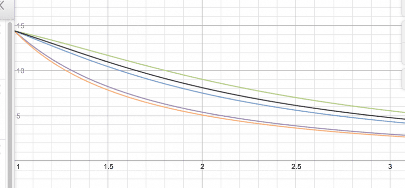

$$D(s) = \int_1^s \frac{ds}{H(s)}$$
So the distance, from the present observer at s=1 out to a source at s=2 is the area under the curve between 1 and 2. Likewise for source at other values of s. These curves (top to bottom) are in order of the inverse rates 16.3, 17.3, 18.3, 40, 1000. A very large number like 1000 corresponds to H so small as to be negligible.
In 1998 it was discovered that the distances corresponding to various s were LARGER than they would be for H = 0, the standard candles were DIMMER than expected. They homed in on 17.3. The top curve, green 16.3, gives areas that are too large, and those the blue 18.3 curve gives are too small. You have to pick one H that gives the right distance for each stretch s over the whole range, these being shown by the areas under the curve, out to that particular value of s.
the upshot is you find Hnow and H by fitting "redshift-luminosity" (i.e. wavestretch-distance) data.

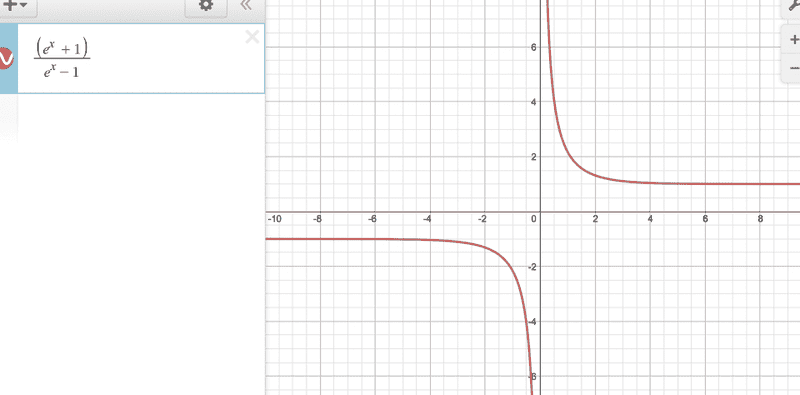

What if you aren't familiar with the "coth" function? How can this be made less off-putting?
$$\coth(x) = \frac{e^x + e^{-x}}{e^x - e^{-x}} = \frac{e^{2x} + 1}{e^{2x} - 1}$$
So another way of writing the expansion rate H(t) = Hcoth(1.5t) is
$$H(t) = H_\infty \coth(\frac{3}{2}t) = \frac{e^{3t} + 1}{e^{3t} - 1}$$
Have to think how the"coth" (hyperbolic cotangent) function can be helpfully introduced.
The function plotted here is one of the simplest you can make out of ex that has a certain symmetry: flipping it right to left (e.g. reversing the time direction) is the same as flipping it over top to bottom. And AFAIK it's the simplest such that, when interpreted as the rate of distance expansion and contraction, describes a symmetric universe that first goes thru steady contraction (constant negative expansion rate), then a swift crunch, then a rebound with an initially rapid expansion, that finally settles down to a steady rate. In other words settles on a constant "percentage" or fractional rate of exponential growth.
The hyperbolic functions are trig function analogues which you get if you start with ex and make the easiest possible moves to get functions that are symmetric in various ways. People can look them up: "hyperbolic functions" in wikipedia etc. For example, recall that the cosine equals itself run backwards cos(x)=cos(-x) We can get the same symmetry from ex just by writing (ex + e-x)/2 and that is called cosh, for hyperbolic cosine. And (ex - e-x)/2 run backwards equals the negative of itself, analogous to sine(x) so it is called sinh.
Well coth(1.5t) is the one of these simple functions that has the symmetry you'd expect of the expansion rate in a collapse-rebound scenario like the one we just depicted and discussed.. I just happens to be how the distance expansion rate in our expanding universe behaves. (The expansion part we can see, we don't know that there ever was a contraction part, if the equations describe a prior contraction that just counts as an "unverified extra" in the symmetry department.)
So let's try to find the MINIMUM SET OF EQUATIONS to describe the universe process. One equation would certainly be H(t) = coth (1.5t), which by definition is also equal to $$H(t) = \frac{e^{3t}+1}{e^{3t}-1}$$ If you aren't familiar with hyperbolic functions you may prefer to see it spelled out like that.
And H(t) can be inverted or solved for t to give $$t(H) = \ln(\frac{H+1}{H-1})/3$$
So whenever we know H we know the time, and whenever we know the time we know the expansion rate H.
