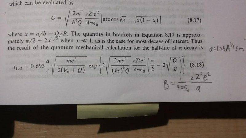

Part (b) is the one I am having trouble with. The 224Ra is known to be an [itex]\alpha[/itex] emitter with a half-life of 3.66 days. What I am having trouble with is the Barrier height B given by
[itex]B = \frac{1}{4\pi \varepsilon_{0}}\frac{zZ'e^{2}}{a}[/itex]
I am under the assumption that Z' is for the daughter; which is 212Pb or 12C in the first decay, and 210Pb or 14C in the second decay? Is z for the [itex]\alpha[/itex] particle? And finally, is [itex]a[/itex] the nuclear radius of the 224Ra?
If I can figure out that relationship, then I think I could go through the process and figure out the half-life by the following relationships.
[itex]\lambda=f P[/itex]
where [itex]P = exp(-2 k_{2}(1/2)(b-a))[/itex] and f is the frequency with which the alpha presents itself at the barrier. How does one calculate f?
From there it is just simply [itex]t_{1/2} = \frac{ln(2)}{\lambda}[/itex]. Any help and suggestions would be appreciated.

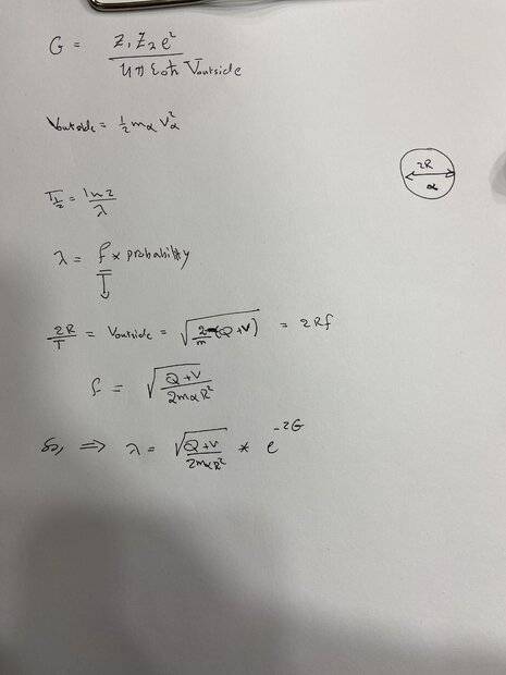

I know its like 5 years into the future, but here is the equation I think you need for half life. I am also stuck on this too so I am replying to bump this and maybe hijack this thread if you are no longer around

Hi, i just answer you of how to calculate the frequency to measure the half life
