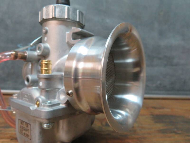

We not always need to exactly calculate the entrance length for full development of flow.
It is important for location of instruments in pipes and to reduce restriction to the flow formed by reduced free cross-section.
These articles may be helpful to you:
https://en.wikipedia.org/wiki/Entrance_length_(fluid_dynamics)
https://en.wikipedia.org/wiki/Velocity_stack
