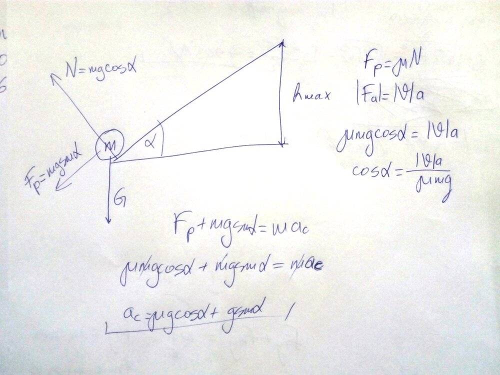

A small mass m is moving from the base-towards the top of a plane, leaned at an angle α to the horizontal base, with starting velocity Vo. There is friction with the plane and air friction force acting, and of course the gravitational force G. Find the equation for the mass' movement and the maximum height it will reach.
air friction force -> Fa=V*a (a is a constant)
plane friction force-> Fp=μG
A rough explanation of my attempts:
I set the coordinate axis in a way that x is the horizontal base and y is perpendicular. But I guess it is a 3d problem, so I struggle finding the right position of the coordinate system.
Then, my next step was applying 2nd NL for every axis. So far I have found the acceleration and the time the mass reaches the highest point, but I doubt its correctness and I am really getting nowhere.

... and you'd like someone to tell you if it is. Can't quite see from here...
Draw a FBD and then we can discuss it meaningfully.

Handwritten physics sketch: a ball on an incline at angle alpha with forces N = mg cos alpha, Fp = mg sin alpha and weight G, plus friction and acceleration equations ending with ac = mu g cos alpha + g sin alpha.
MerS said:
At one place you have ##F_p=mg\sin(\alpha)##, at another ##F_p+mg\sin(\alpha)##.
You seem to have omitted drag.
You posted that you had found the time to reach the highest point. Where is the working for that?
