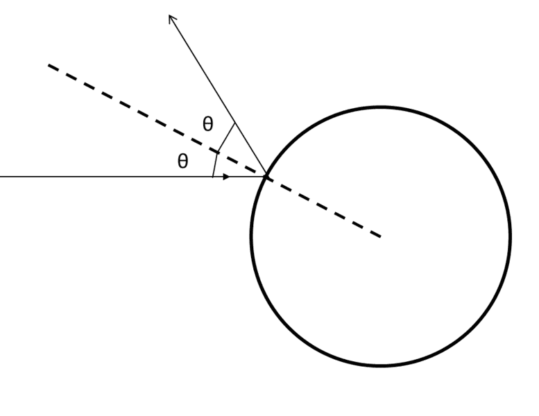

I think you need to find out how much momentum the molecules that strike the cylinder due to the wind must carry so as to cancel out the weight of the cylinder.
This should be very similar to how the pressure of gas is found given its temperature (or the root mean square velocity of its molecules).
I am a bit confused. When an air molecule collide with the curved surface of cylinder, won't it bounce at an angle?
I thought that the cylinder had its flat sides parallel to the ground.
But it is not really much different if it is the other way around, just find out how a ball would collide with a circular wall.
Please see the attachment. Is it correct?
Correct. You just need to integrate over the lower half.

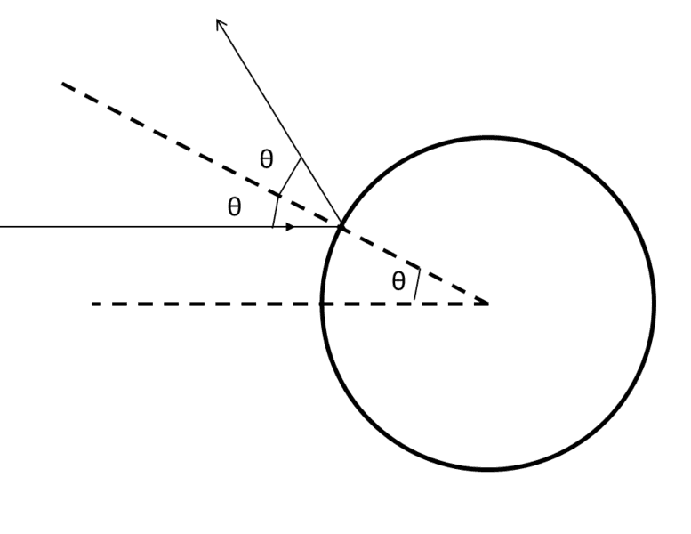

Let the mass striking the cylinder be ##dm##. Initial momentum ##p_i=dm v## in vertical direction. Final momentum in vertical direction ##p_{fv}=dmv\cos(2\theta)## and in horizontal direction, ##p_{fh}=dm v\sin(2\theta)##.
Change in momentum in vertical direction, ##dp_v=-2dmv\sin^2\theta## and for horizontal direction ##dp_h=dmv\sin(2\theta)##. I think the force due to change in horizontal momentum will be zero due to symmetry.
The problem is how to express dm in terms of other variables? :confused:
Thank you for your time.
How much air collides with the cylinder over ## dt ##?

Hmm. You diagram in #12 has the angle measured from the horizontal, and the incoming air is also horizontal. The problem says the incoming air is vertical, and you clearly regard that direction as vertical, because that is how you compute the diff in the momentum. If that is so, then I should withdraw my previous remarks - you should have ## \cos \theta ## in the effective area just like you did originally, even though the discrepancy between the sketch and the description is unfortunate.
In #12, I am not sure I understand how you got the minus sign. Other than that. I think your formula is correct.
Pranav-Arora said:
Nope, that doesn't give the right answer.
I went through it again, and now I'm getting 4/3, not 2/3.
Your diagram seems to be on its side. So we agree you want ##\int _{-\frac \pi 2}^{\frac \pi 2} dmv(1+\cos(2\theta))##, where dm/dt = ρ hr cos(θ)vdθ?
I am extremely sorry for misleading words. I tried my best to write post #12 in a proper way but I was already expecting this type of problem to occur. Sorry. :redface:
And my formula is wrong. I forgot to take into account the vector nature of momentum. Hence ##dp_v=dmv(1+\cos2\theta)##.
Thanks for the help and your time voko, I have reached the correct answer. :smile:
