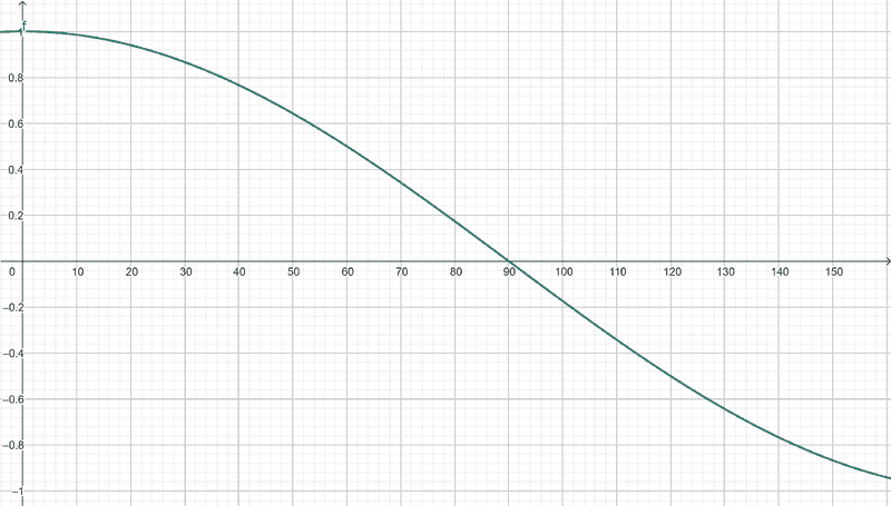

Let me plot with with Geogebra (can I do this?) the cosine part of the magnetic flux:
The sign of the first derivative doesn't change in the range from zero to 120 degrees. Thus, if we assume the loop's resistance is high enough to neglect inductance effects, the induced flows in the same direction.
