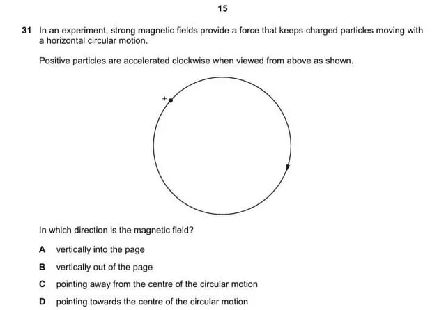

Good day,
Im a high school student currently working on my exams, I have came across a past paper question in which my answer contradicts the mark. To answer the question i used the right hand thumb rule since the direction of positive charge movement is similar to conventional current and figured out the direction of the magnetic field would be into the page A. However the real answer seems to be B (according to the mark scheme). After some thinking i reasoned that it had something to do with centripetal or centrifugal force which would require the left hand rule, but i still don't understand clearly why it is B.

In what direction is the force on the particle?
inward towards the center (centripetal force)?

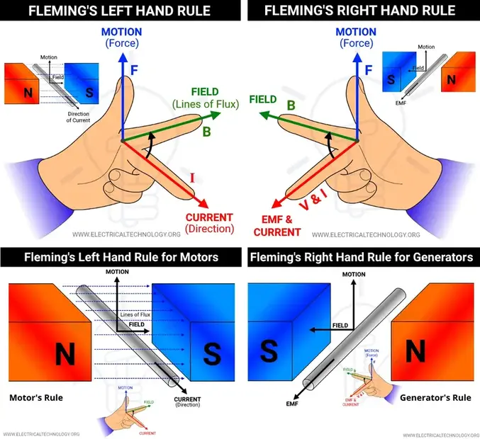

i thought it was flemings left hand rule. How do we relate this with the question, is there not a strait up solid answer
Apparently that's the same for a magnetic field. You have to know which finger matches which vector.

The straight answer is that the magnetic field is out of the page. Answer B.

I would do it using vectors. Assume the circle is in the x-y plane, with the positive x-axis to the right,the positive y-axis upwards and the positive z-axis out of the page.
Note that the charge is positive.
The Lorentz force is:$$\vec F = q\vec v \times \vec B$$When the velocity is in the positive x direction, the force is in the negative y direction. This implies the field is in the positive z direction, as:
$$\vec i \times \vec k = -\vec j$$
If the charge were negative and moving clockwise, then the field would be into the page.

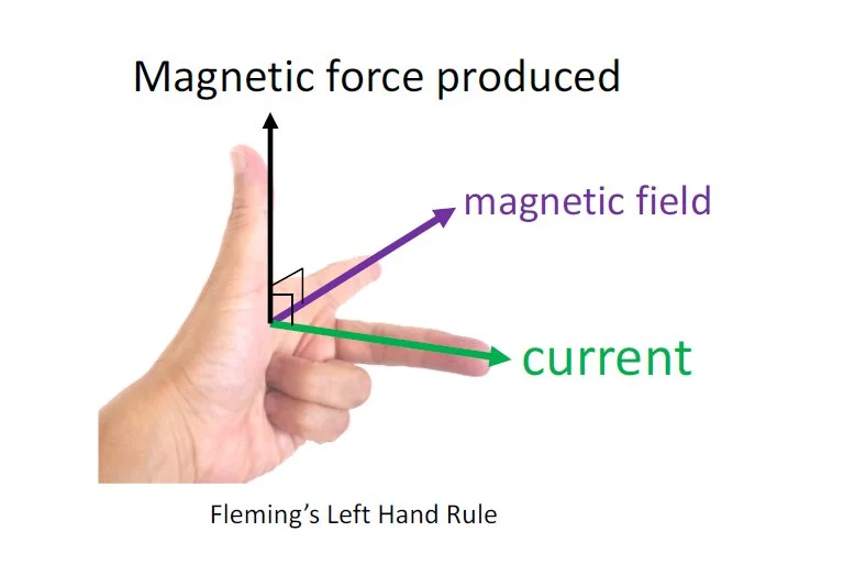

I was taught to use 'Fleming left-hand motor rule' in this situtation:
There are equivalent alternatives which use the right hand. If you want to look them up, use a search term such as "right hand rule force current magnetic field" (and look at the images).

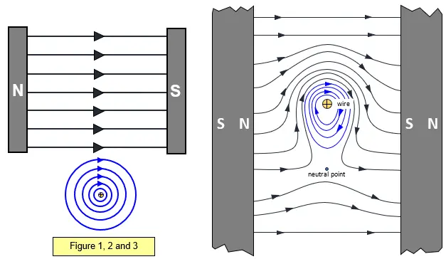

No. The moving positive particle produces a circular field: outside the orbit, the field is out of the page; inside the orbit, the field is into page.
physicals said:
but that doesn't automatically mean the direction of magnetic field causing the motion is into the page. To verify that we, know that for circular motion we need a centripetal force acting inwards towards center of orbit, thus the direction of the external magnetic field causing motion must be the same as direction of magnetic field created around the positive particle
No. To produce a radially inwards force, the field lines outside the particle's orbit must be more densely packed than the field lines inside the particle's orbit. This occurs when the external field is as given in answer B.

No. Look at the following (current going into page) and decide if, inthe right-hand diagram, the conductor is pushed up or down.
(Diagram from https://www.schoolphysics.co.uk/age...e_on_a_current_in_a_magnetic_field/index.html)
