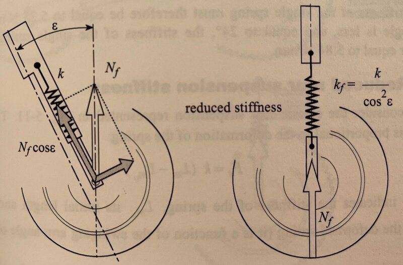

Hello,
I have a problem with reducing a stiffness of a front suspension. Unfortunately I don't understand how to get the reduced stiffness on the right side in the picture. (k_f=k/cos^2E)
Thanks in advance for your help.
Many greetings,
Semat10
The vertical stroke equals the inclined stroke times the cosine of angle ε.
Hello,
I was thinking the same thing but I don't know where the square came from?
Many greetings
The force of the vertical spring must be less than ##N_f*cos (ε)## ; therefore, the vertical stroke must be proportionally smaller ##(cos (ε))## than the inclined one (accounted for twice).
##k_{vertical} = N_f / {Vertical~stroke} = N_f / {Inclined~stroke}*cos (ε)##
##k_{vertical}/k_{inclined}=?##
