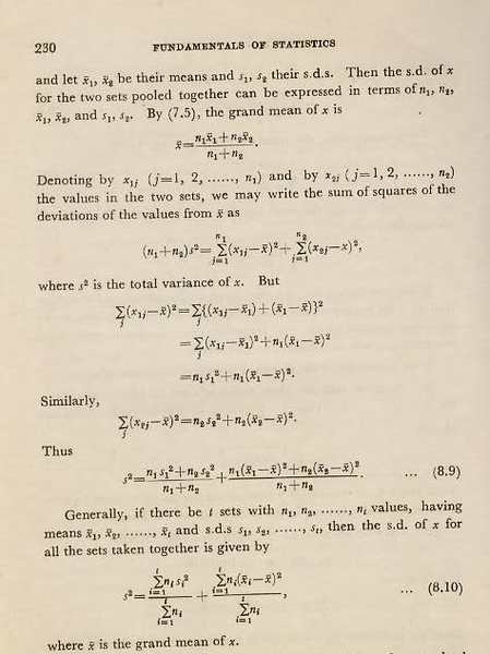

From where did I get the expression: I knew it and worked it out first time 25 years back, and regularly proving/teaching this till date. (And no one could disproved it upto 9th nov, 2008.)
If you cannot workout from definition of sd (or sd^2) then for your information I am attaching the elementory calculations worked out in standard text. Hope you will be able to understand them.
Pls note: The symbols for means and pooled sd in the print is different than what I wrote (they used x_bar, where I used mu. For the pooled sd, they wrote s, I used s_p. But I think you will understand that it really makes no difference in the mathematics).

Hi ssd,
I have been searching various forums, posts & references trying to find a way of combining standard deviations. I think the method you quote is what I'm looking for, so could you please tell me, who the Author is of the book (Fundamentals of Statistics), you quoted earlier?
Thanks
The Authors are: A.M.Goon, M.K. Gupta, B. Dasgupta. (All from India).
Publisher: The World Press Private Ltd.
Info: More than 7 editions have been done before 1990.
Hi ssd,
Thank you for scanning the page. I have just one question, and I hope you can enlighten me. :)
The equation in the middle of the page gives:
sum_j(x_1j -x_bar)^2 = sum_j{(x_1j - x1_bar) + (x1_bar -x_bar)}^2
why it is equal to
sum_j(x_1j - x1_bar)^2 + n1 (x1_bar -x_bar)^2
isn't there a part missing
sum_j(2*(x_1j - x1_bar)(x1_bar -x_bar)) ?
Please help me to understand this.
Thanks
[tex]\sum_j (x_{1j} - \bar x )^2 = \sum_j ( ( x_{1j} - \bar x_1 ) + (\bar x_1 - \bar x ))^2[/tex]
[tex]= \sum_j ( x_{1j} - \bar x_1) ^2 + \sum_j (\bar x_1 - \bar x )^2 + 2 \sum_j (( x_{1j} - \bar x_1)(\bar x_1 - \bar x ))[/tex]
[tex]= \sum_j ( x_{1j} - \bar x_1 )^2 + \sum_j (\bar x_1 - \bar x )^2 + 2 (\bar x_1 - \bar x ) \sum_j( x_{1j} - \bar x_1 )[/tex]
[tex]= \sum_j ( ( x_{1j} - \bar x_1 )^2 + \sum_j (\bar x_1 - \bar x )^2 + 2 (\bar x_1 - \bar x )( \sum_j x_{1j} - \sum_j \bar x_1 )[/tex]
[tex]= \sum_j ( x_{1j} - \bar x_1 )^2 + \sum_j (\bar x_1 - \bar x )^2 + 2 (\bar x_1 - \bar x ) (n_1 \bar x_1 - n_1 \bar x_1 )[/tex]
[tex]= \sum_j ( x_{1j} - \bar x_1 )^2 + \sum_j (\bar x_1 - \bar x )^2 + 2 (\bar x_1 - \bar x ) (0)[/tex]
[tex]= \sum_j ( x_{1j} - \bar x_1 )^2 + \sum_j (\bar x_1 - \bar x )^2[/tex]
[tex]= \sum_j ( x_{1j} - \bar x_1 )^2 + n_1 (\bar x_1 - \bar x )^2[/tex]
As I understand the scanned text, if you want to compute the pooled sample variance of two samples, you could simply treat all the data as one sample and do it that way. In this age of computers, that might be simplest thing to do. The formula for the pooled variance gives exactly the same result as doing that.
As pointed out in previous posts, there is a difference between the variance of a sample (pooled or otherwise) and a computation using sample values that is proposed as an estimator of the population variance (or of the common variance of two different populations). The formula for the sample variance may or may not be the best estimator for the population variance. Whether it is, depends on how you define "best" and what information is known about the distribution of the population.
