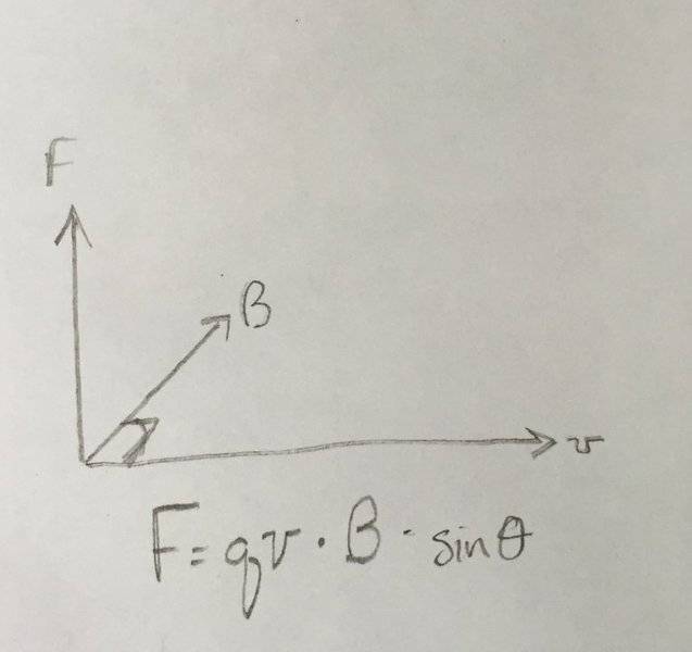

Ok so the problem I am wanting to understand is the effect of a magnetic field on a charged particle along a straight wire, like this:
Where the magnetic field is given by:
B = m(o)I / 2πr
I = 3A
m(o) = 4π x 10-7 T · m / A
r = 0.50m
q = +6.5 x 10-6 C
v = 280 m/s
I get a B of 1.2 x 10^-5 and a Magnetic Force of 2.184E-08 C * m/s * T
This would be the magnetic force experienced by the particle running parallel to the wire. From what I understand, the particle is affected the most by the magnetic force when the field is perpendicular to its velocity vector as in this picture:
So what I am trying to understand is, when the field is perpendicular or at 90deg to the velocity of the particle, sin90 = 1, so at that moment that component is eliminated. So when the field is applied while ⟂ to the velocity, the particle's direction changes. This means that the particle's velocity is no longer exactly perpendicular to the field. This means that to keep the particle moving, we must change the direction of the field to adjust.
What I want to understand is how to use calculus to understand how the direction changes as the field changes?

I do not understand this statement:
"This means that to keep the particle moving, we must change the direction of the field to adjust." Why do you think so? What do you want the particle to do? There are tow types of problems:
1. The field is given, and the initial position and velocity of the particle are given, find the subsequent path of the particle
2. You want the particle to follow a given path, with given initial conditions, find the configuration of the fields, if such a solution is possible.
What do you need?
What caught my attention was that I believe I read somewhere that this is how the particle colliders work in terms of how they accelerate the particles to move in a circle, is this correct?
We apply a magnetic field ⟂ to the particle's velocity and it changes course, but now the field isn't ⟂ to the particle anymore...We must figure out how the velocity changed in order to change the field in such a way that the particle will keep turning in the direction we want it to such that it goes around in circles, right?
Q1/ How is that done?
Q2/ I would assume it has to do with calculus since it would be the study of how angle changes as the force changes, no?
Suppose we apply a constant magnetic field along the z axis and give the particle an initial velocity in the x-y plane The force on the particle will be perpendicular to both the direction of travel and the field, so the particle will remain in the x-y plane and the magnetic field will remain perpendicular to the direction of travel. The effect is that no matter what direction the particle is travelling, as long as it remains in the x-y plane, it will be deflected to one side of its direction of travel. The result is uniform circular motion in the x-y plane even though the magnetic field is constant.
