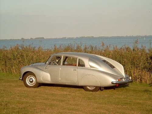

What about the following car designs? They look streamline to me. Will they experience lift?
http://www.1motormart.com/glosimgs/sedanet.jpg
[URL]http://www.allsportauto.com/photoautre5/voisin/c28/1936_avion_voisin_C28_aerosport_07_m.jpg[/URL]
[PLAIN]http://www.carpages.co.uk/volkswagen/volkswagen_images/volkswagen-passat-cc-14-01-08.jpg
[URL]http://www.exelerocar.com/images/exelero/exelero-15.jpg[/URL]

There is a difference between streamlined and a lifting body. A car likely does experience some degree of lifting force, but it is not designed as an airfoil, so it isn't going to be very good at it, and they weigh so much it won't matter. Compare it with a wing where the wings are made of aluminum and are as light as possible.

My understanding is that yes, if you just slap together a car without giving it much thought, it does tend to produce lift. When you start getting into high speeds you do need to keep this in mind when designing a car. The lift is likely not going to be even close to lifting the car off the ground (unless you start getting into 200mph+ speeds), but any lift is detrimental to a car's traction, performance, and stability...which coincidentally you need more of the faster you go.
So yes, sports cars makers DO look into to this phenomenon and go out of the way to try to at least reduce it (and of course, in some cases, even reverse it).
